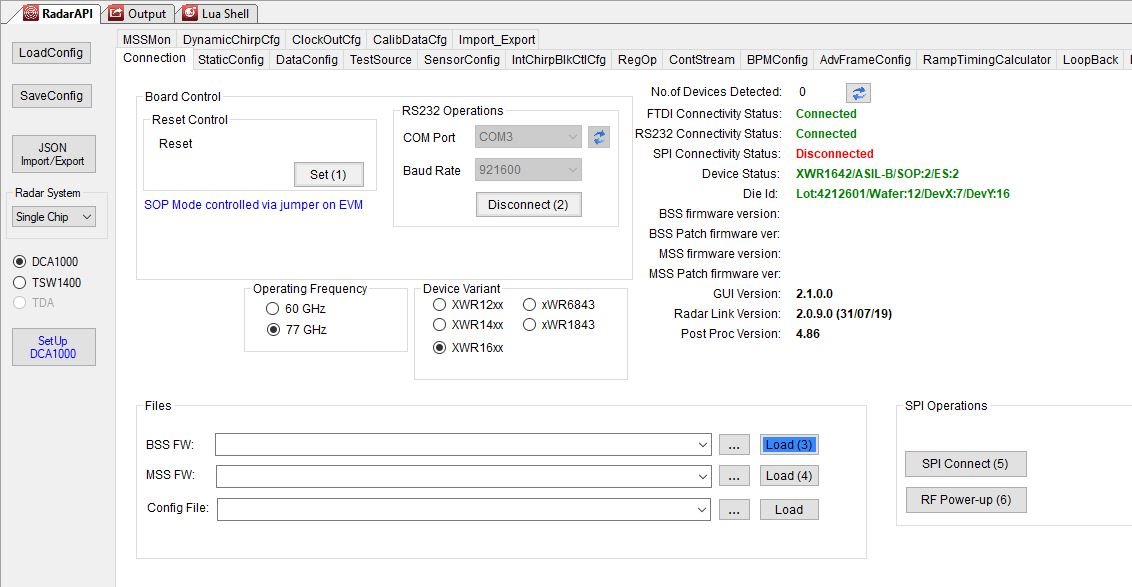

    In mmWave studio, we've established the connection by putting the AWR1642 into SOP2 mode (Jumpers on SOP0 and SOP1 should be closed and SOP2 should be left open to set the device in SOP2 mode). So shows FTDI, RS232 and SPI connected.

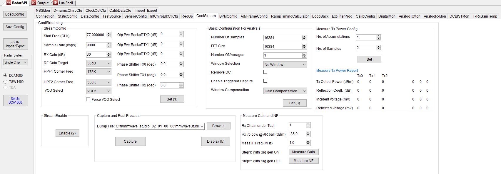

    Ant then afterward checking the ContStream tab doesn't show any option to make the CW setup. Can you please post a screen shot and necessary setup to config. e.g. 77GHz CW mode?

  • Hi Kyle,
    Find attached screenshots from connection tab and then from contStream tab.
    Can you provide brief instructions how to setup and launch continuous stream @ 77GHz? Is there a way to check that without spectrum analyzer. E.g. ,w/ oscilloscope?
    Thanks forward.
    M.
