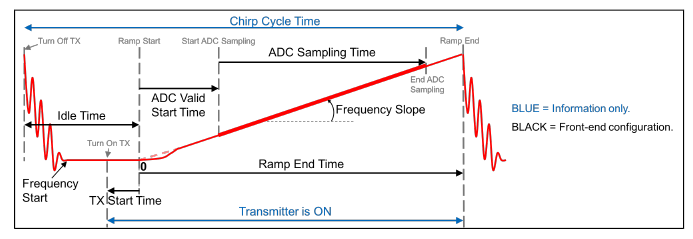

IWR6843: What causes the non-linearity at the start of the chirp?
Part Number: IWR6843
In related post, (e2e.ti.com/.../730050)
there mentions that the non-linear behavior in the beginning of the chirp is due to "various settling time".
What are these settling times due to?
I ask because I want to find a good value for adcStartTime, I will use MMWAVE-STUDIO to compute the ADC Start time parameter based on the inputs provided for Ramp Slope, sampling mode, sampling rate,number of samples etc. as recommended.
