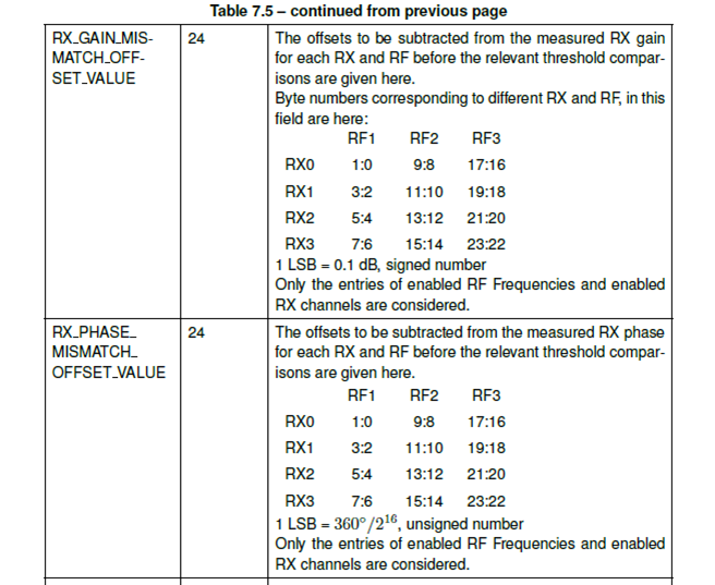

     In 7.3 RX Gain and Phase Monitor of AWR1xxx Radar Interface Control Document,
I  have the questions. Can I find more documents about AWR1xxx Monitoring Config?
  1. What is the meaning of the following 24 values. (12 for gain/12 for phase , each value are two byes).
  2. How to decide the value for each of them?
