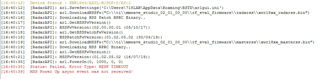

I get some SPI connection problems on mmWave studio and the devices that I'm using are  AWR1843Boost Rev. B and DCA1000EVM.
The device status and error messages are shown below:
Thus, I'd like to know that is anything else needed to be set up?
Thank you very much.
Jimmy

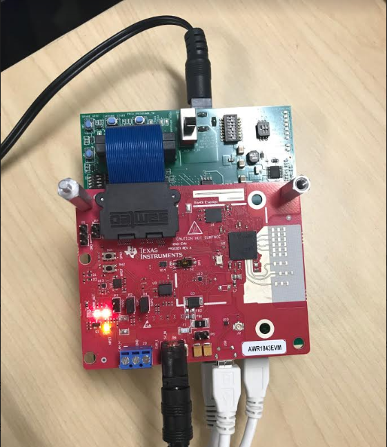

  • Hi, Jimmy:
    Please send out a picture of your setup when you see this error.
    Zigang
  • Hi, Zigang
    My setup is:
    Thank you.
    Jimmy

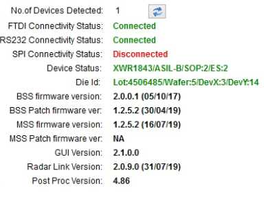

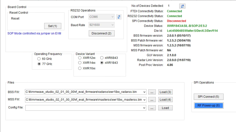

  • Hi, Zigang,
    In the picture above, the error shows up after I click the button---"SPI Connection(5)".
    And I've also checked my switch setting. It's equivalent to SOP jumper [SOP0: ON, SOP1: ON, SOP2: OFF].
    Does anything else have to be done?
    Jimmy

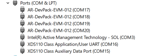

  • Hi, Jimmy:
    I have attached my picture for your to check with yours.
    You should see 6 ports in your device manager.  And here also attached the picture of the setup.
    Zigang
  • Hi, Zigang,
    I could connect SPI now.
