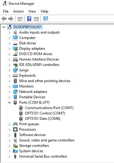

    This error (flash) is actually expected so this is not the issue. Could you paste the full data log from the log window when you run? Also Latte opens an additional black command prompt window in the background. After running can you also check this window for errors? Can you also provide a screenshot of your COM ports in device manager? This should help be debug this further. Also if you can provide a photo of the front view of your EVM that would be helpful as well.

    Here is a screen shot of the ports:
    Just curious, what should the baud rate be set to?

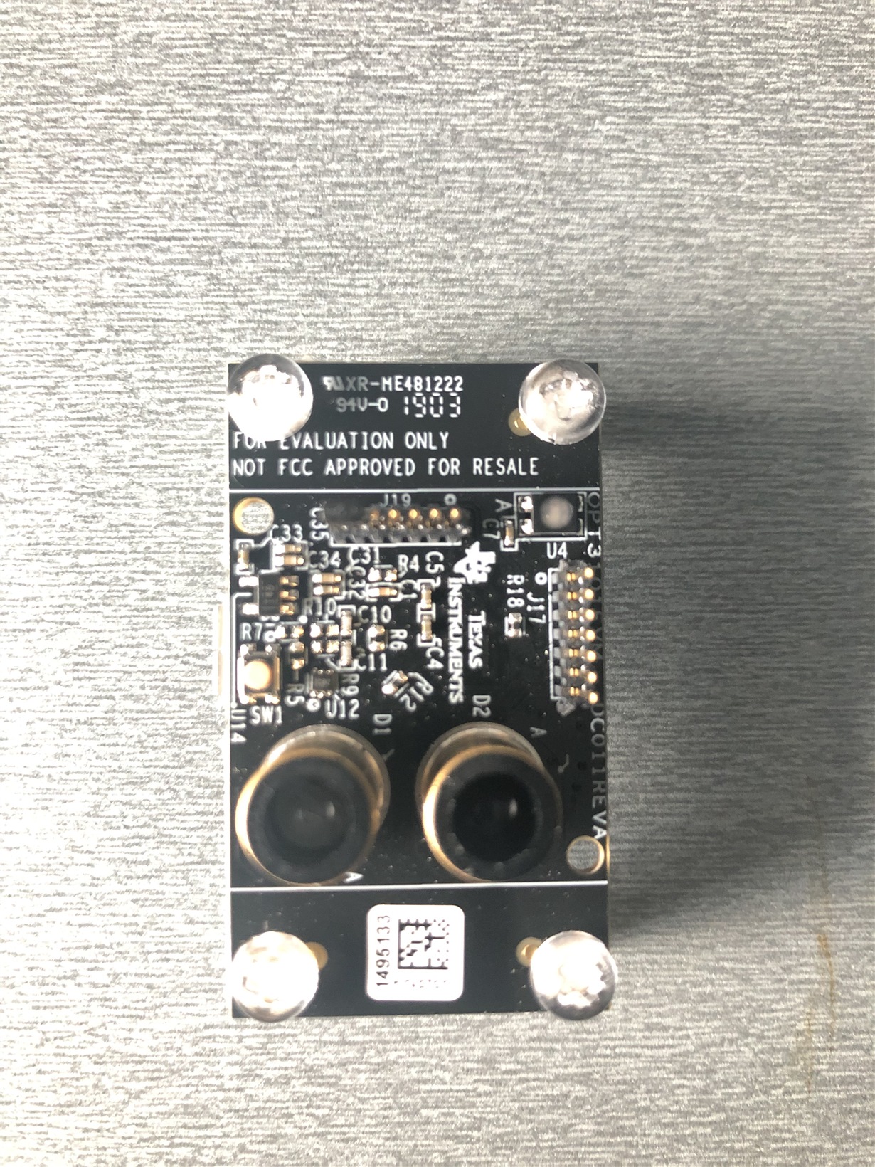

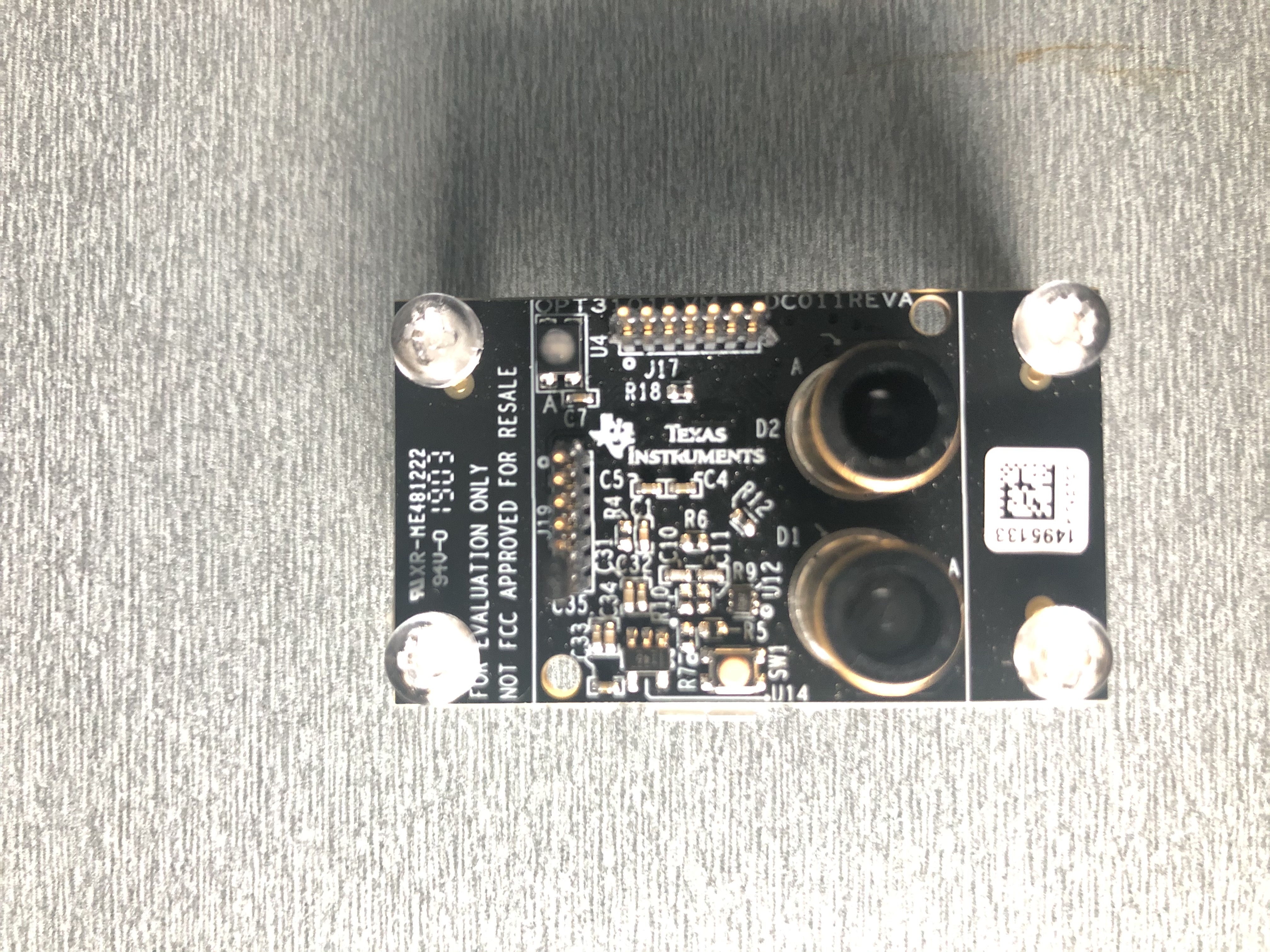

    Lastly, here is a photo of my EVM
    I think that's it. Thank you for helping out.

  • Hi Brandon,
    I don't see anything amiss in the logs here. It looks like the software is able to communicate find with the EVM. Have you tried power cycling and restarting the computer to make sure it couldn't be anything strange there?
