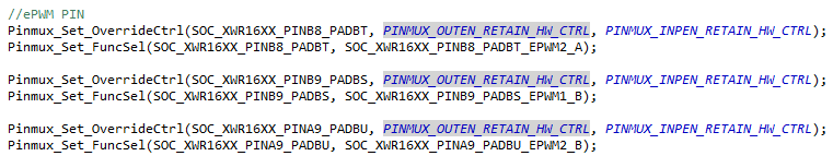

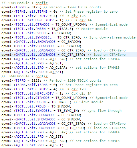

Hi TI team,
As I set the frequency of ePWM1 and ePWM2 at 5 Hz, only the one of them can output the signal.
But if I stopped the RF, both of them can output the signal correctly at 5 Hz.
We guessed that the current was restricted by the IC.
If I set the frequency at 1 kHz, the function works normally and I need not to close the RF function.
Please help us to figure out this problem.
Thank you.
