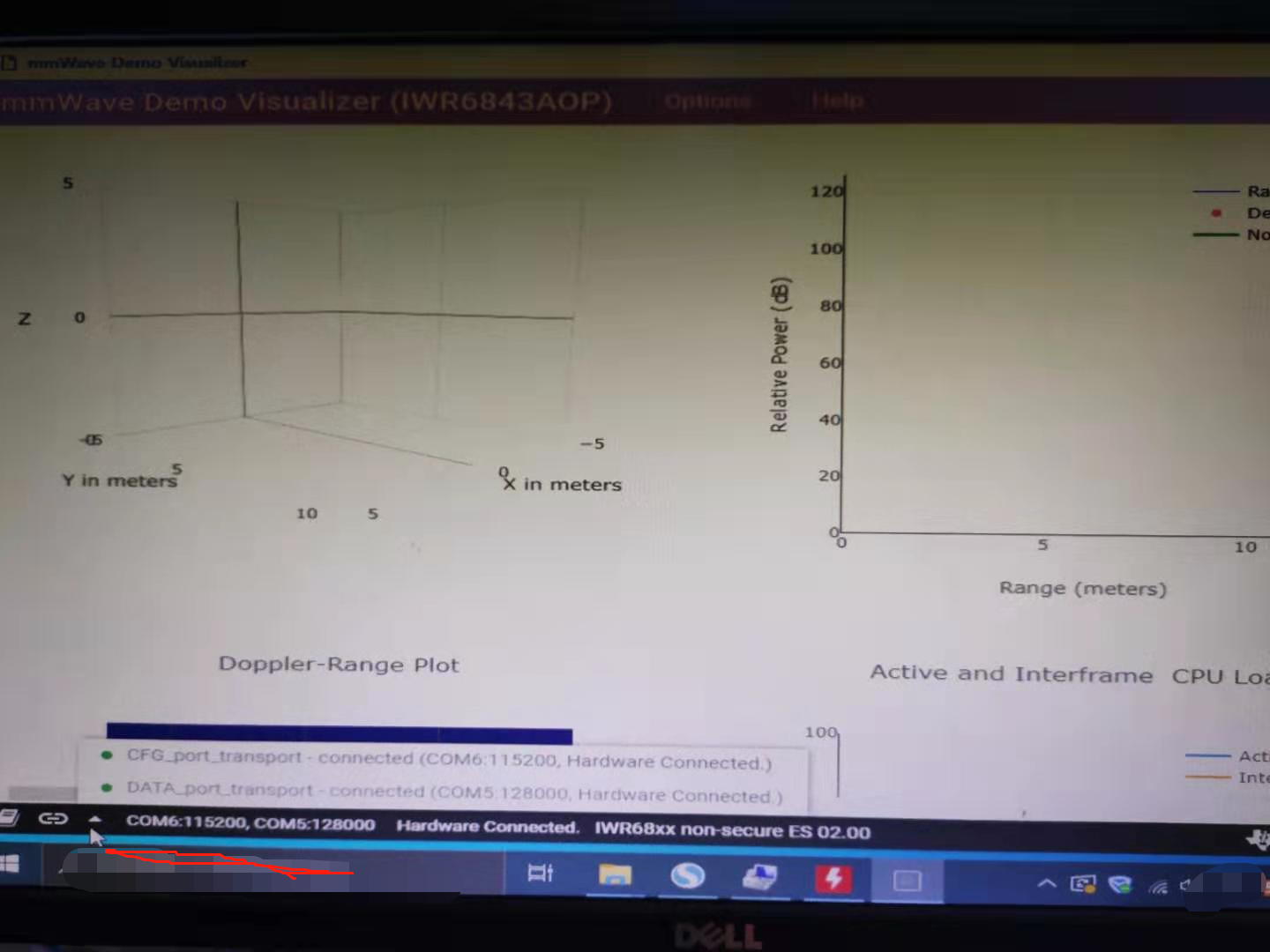

  • Thank for your reply,when we run the ODS Point Cloud Demo you recommended,we have encountered new problem:
    When we click on Configure to connect the GUI to the EVM. The GUI Status bar never show Conected:
    On the contrary,it constantly shows both CFG_port and DATA_port waiting for data....
    These are as shown below:
    Please give some advice.
    regards,
    2019-11-14
    enderror

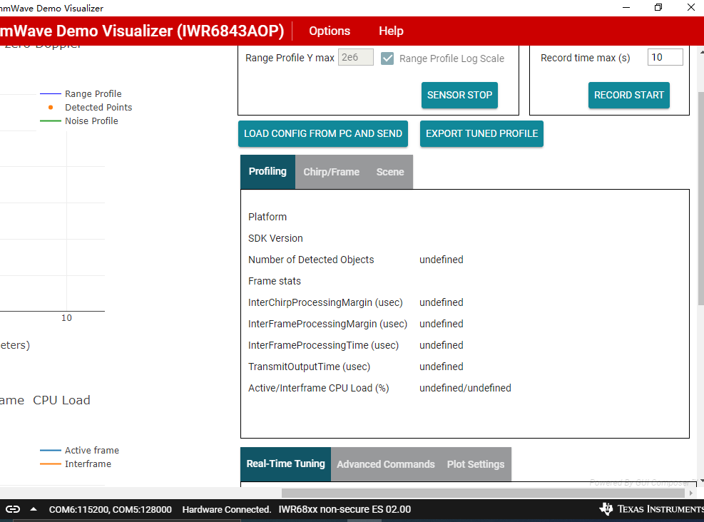

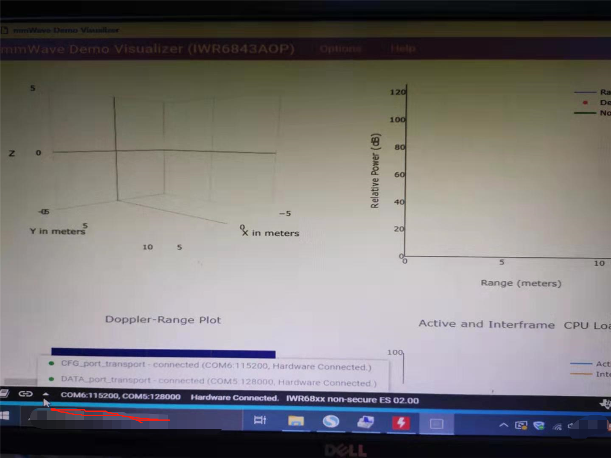

  • Hello,thank you very much for your reply.
    we have followed the  User Guide to run the  ODS Point Cloud Demo,now,both  CFG_port and DATA_port  have been connected,however,there are no plots just as figures bellow:
    Please give us some suggestions.
  • Hi Yuhao,
    Could you post the output from the console?

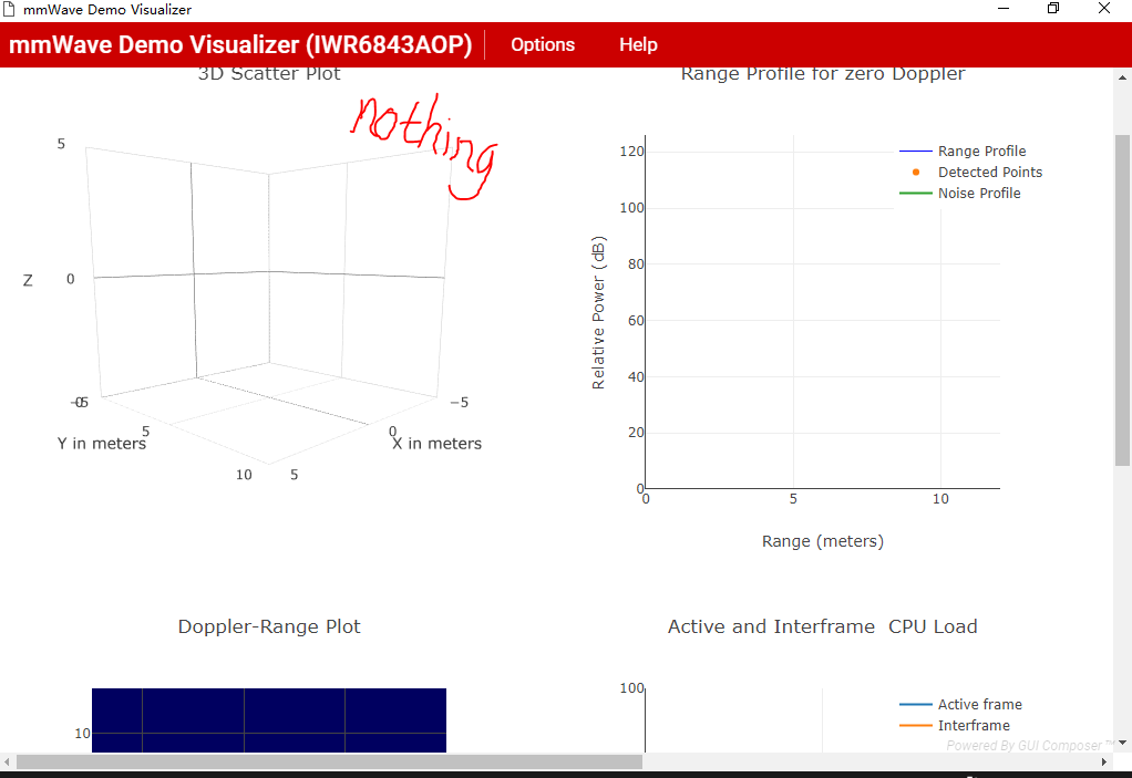

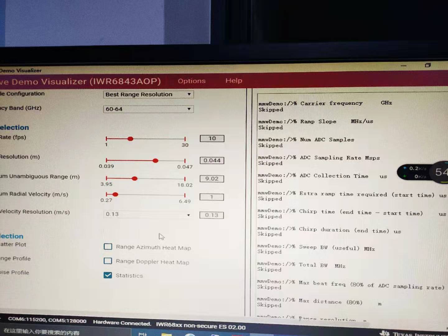

  • I have try   ODS Point Cloud Demo many times,it's still show nothing.I'm sure all steps are following the demo user guide,and I don't know where is the problem. The following are some Screenshots,and also reply you with  an attachment about the console messages.
    looking forward to your reply.

  • Hi Yuhao,
    There is a new version of the Industrial Toolbox 4.1.0 (new as of 12/1/2019), please download this new version, walkthrough the updated user guide, and let us know if you are still having issues.
    Cheers,
    Akash
