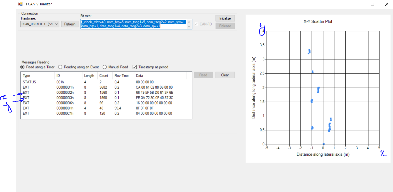

I'm using awr1642 boost Rev B, I'm actually  testing object detection over CAN lab, On th MMWAVECANVISUALIZER app, there's message reading  and (x,y) plot. I would like to plot Range-Doppler heat map instead of (x,y) plot. Also I have some questions :
  1. How to interpret (understand) messages reading ? what do they present?
  2. Does awr1642boost send only (x,y) over CAN bus (I need targets velocities (doppler))?
Thank you
    Please note that every demo we provide can be updated to send the data over CAN.
    We provide the demo object data  over CAN as an example.
    Please feel free to update this demo to send the heat map
    You would need to develop the PC gui to accommodate the data sent.

    I had read the document "adding can bus to an existing project", but this is not my issue. I'm trying to locate on the ODOC lab MSS main the selection of
    the data to be sent via CAN BUS ( x,y in the existing lab) and then choosing heatmap ?!
    You would have to modify in the following file the "guiMonitor" command
    C:\Users\a0323124\TIREX\mmwave_automotive_toolbox\labs\lab0005_object_data_over_can\odoc-target\mss\cli.c
    The "guiMonitor" command is described in the SDK 2.1 UG
    C:\ti\mmwave_sdk_02_01_00_04\docs\mmwave_sdk_user_guide.pdf
