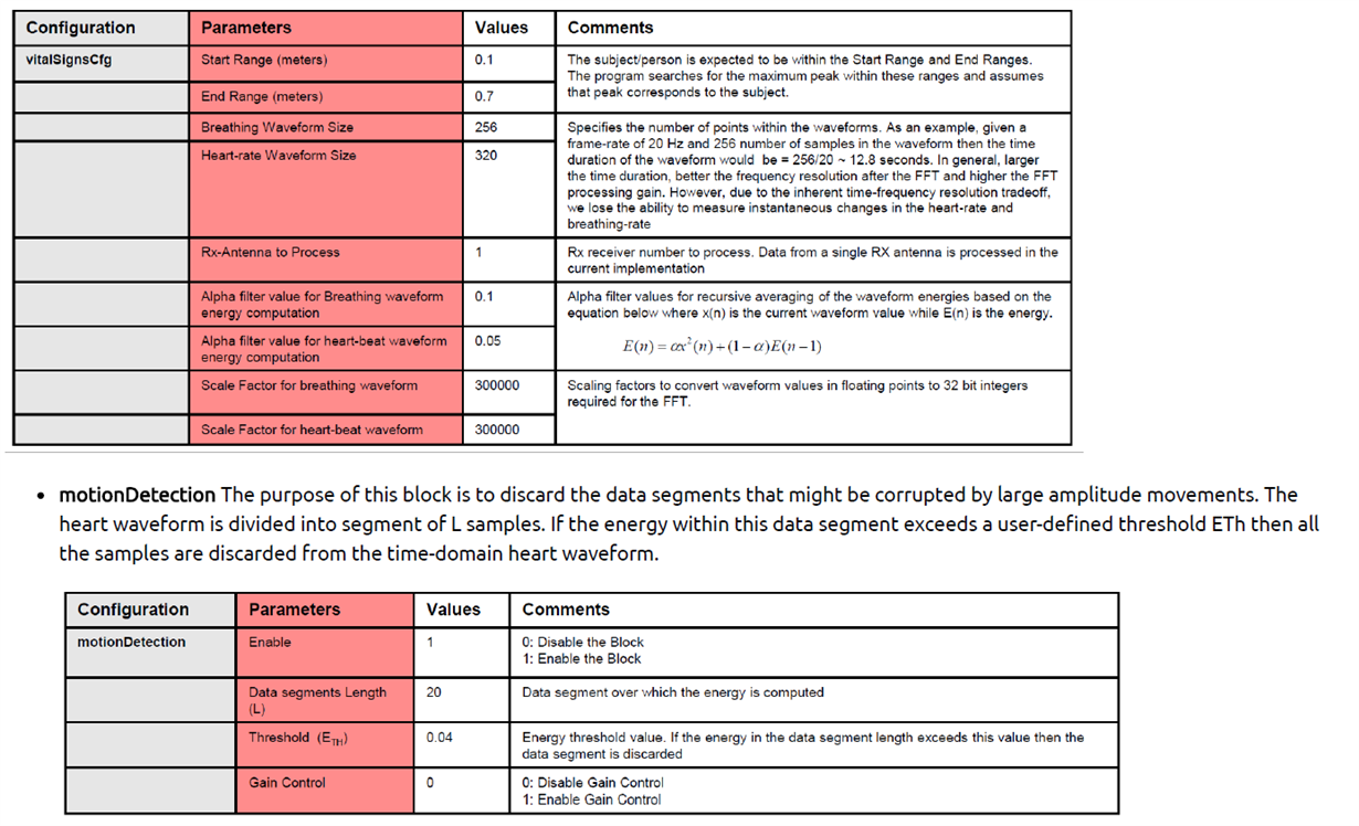

1) Are there better profile settings for the VitalSigns program that are tested?  Please share your the values used for let's say vitalSignsCfg and motionDetection parameters.
2) Are there tweaks done on settings to make it good for VitalSigns detection? Here is the included profile in the VitalSigns demo, Let me know your thoughts on the choice for chirps and frame design that you found to be good.    For VitalSigns demos, the test subject is within 0.3 to 1m away from sensor (very close) and is not moving as much with a chair on his back, and we are measuring the small vibrations on the chest displacement.

vitalSignsCfg 0.3 0.9 256 512 4 0.1 0.05 100000 300000
motionDetection 1 20 2.0 0

  • Answer #1
    There are two vital signs code bases. One that uses the HWA for example on AWR1443) and a second one that uses the DSP (for example on xWR1642). The performance is the same for both code bases
    The same code bases are ported to different platforms. There are no differences in the target code
    Answer #2
    No, performance is the same for both HWA and DSP implementations
    Answer #3
    No the IWR6843 implementation uses only 1Tx/1Rx
