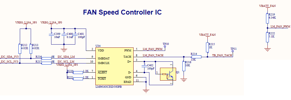

We have checked HW connection, there are no any changes compared to EVM. Is there any SW register setting from which we can make PWM duty cycle stable? Please suggest.
I am attaching here a snapshot of Schematic for your reference. Please help to resolve this issue.

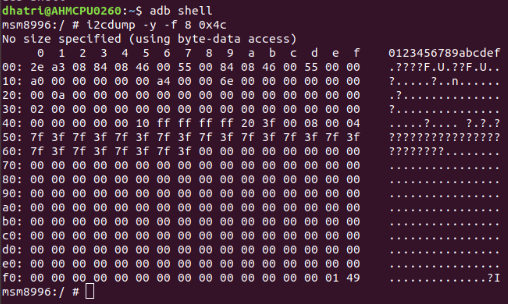

    Thanks for the quick reply. Please find a below-attached image of Register dump from that you can find the required register's values.

    Thank you for the information.  From the settings it looks like you are running at a frequency of 22500 Hz, but the PWM value (0x4C) is set to 0%.  Can you send me oscilloscope waveform with the Duty Cycle variation when 0x4C is set to 50%?

    I do not see the variation in duty cycle on my set up using the same register settings (except 0x4C is set to a non-zero value).  Is this waveform taken at the PWM output pin?  Also is there anything external connected to the PWM pin such as a fan PWM input or transistor?
  • Hello David,
    We have BLDC driver IC to drive Fan, but for the above measurement we have separated that IC to identify which IC creating issue and found at PWM output of LM96163 IC itself having this type of issue. In measurement setup we are only configuring LM96163 IC over I2C and measured  PWM signals at output of IC (5th Pin).
