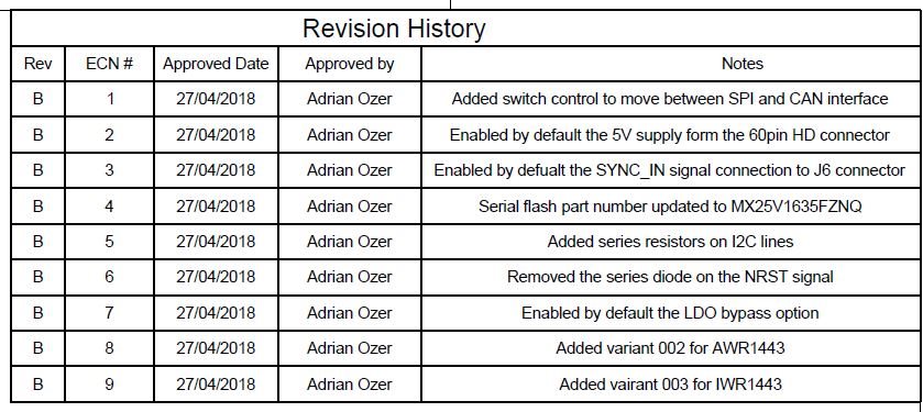

I have two questions about AWR1443BOOST board.
(1) What's the difference between AWR1443BOOST Rev A vs Rev B?
I found the file AWR1443BOOST Schematic, Assembly, and BOM (for Rev B Boards) (Rev. A) is the same to AWR1443BOOST Schematic, Assembly, and BOM (for Rev A Boards).

(2)What's the board version sold on TI estore now? How to buy the Rev B board?

  • Hello Shine,
    All the boards available on TI.com now are all Rev B version.
    By mistake the Rev A link also pointing to RevB files. When you open the schematics you can find the revision in the bottom right label present on all pages.
    The changes made in  RevB with respect to RevA are captured in the first page , right hand top of the schematics pdf.

  • Hello Shine,
    Please find attached the AWR1443BOOST RevA schematics.
    If they need the device symbol, they can use it from the Rev B database which is in Altium.
