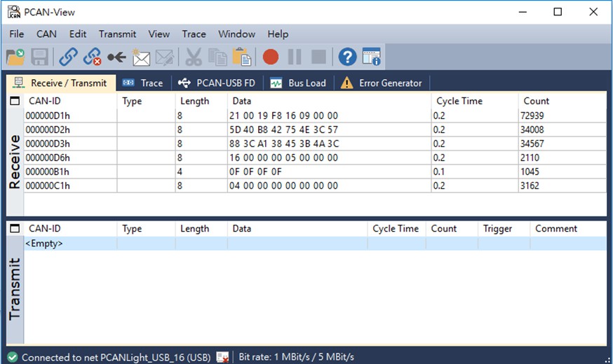

Hi
I got the CAN signal from PCAN-USB, like the following diagram:
What is the meaning of each CAN-ID and how to interpret the data to a value in meter ex: (X,Y) = (6m, 25m)?
BR,
Matt

Hello Matt,
I am assuming that you use the ODOC TI resource project.
Please refer to the code mss_main.c in the ODOC TI Resource project . The enum are provided with the CAN messages .
typedef enum mmwDemo_can_message_type_e
/*! @brief List of detected points */
CAN_MESSAGE_MMWDEMO_DETECTED_POINTS = 0xD1,
/*! @brief Range profile */
CAN_MESSAGE_MMWDEMO_RANGE_PROFILE,
/*! @brief Noise floor profile */
CAN_MESSAGE_MMWDEMO_NOISE_PROFILE,
/*! @brief Samples to calculate static azimuth heatmap */
CAN_MESSAGE_MMWDEMO_AZIMUT_STATIC_HEAT_MAP,
/*! @brief Range/Doppler detection matrix */
CAN_MESSAGE_MMWDEMO_RANGE_DOPPLER_HEAT_MAP,
/*! @brief Stats information */
CAN_MESSAGE_MMWDEMO_STATS
} mmwDemo_can_message_type;
The code should be the reference for you to interpret the data . There is no seperate documentation for the same.

Hi Raghu,
Many thanks for your reply.
I use Lab7 as the base for development.
From the mss.main.c, shown as below, I think D1 is for detected point, D2 is clusters, D3 is tracked objects and D4 (D6) is parking assist.
From other code, i also found B1 and C1 means PADDING and HEADER, respectively. Am i correct?
The other question is how to interpret the data? The data in the following table comes from the PCAN. I found the Q number is 7 in dss_main.c.
If the x data is (DA,FE) and Q is 7, what is the x value in meter?
Is the number of 7 correct for lab 7?
V | Peak | X | Y | Z | |||||
0 | 0 | 2C | 0 | 0 | 0 | 4 | 0 | 7 | 0 |
0 | 0 | 22 | 0E | DA | FE | 48 | 5 | 56 | FE |
0 | 0 | 33 | 0E | CC | FE | 47 | 5 | 3D | FE |
0 | 0 | 16 | 0C | E3 | FB | DC | 9 | 9C | FB |
0 | 0 | 7D | 0C | 19 | FD | 58 | 0A | 6E | FA |
BR,
Matt
