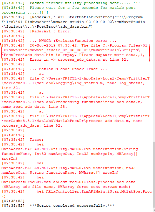

Hello, I am having problems with making the data capture work for the IWR6843AOP EVM.
The "adc_data.bin" File is empty after the frame is triggered:

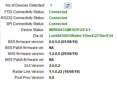

The connection to the device and loading of the firmware seems to work (Note that I using mMWave Studio 02.00.00.02 because the IWR6843AOP is not supported with Version 02.01.00.00):

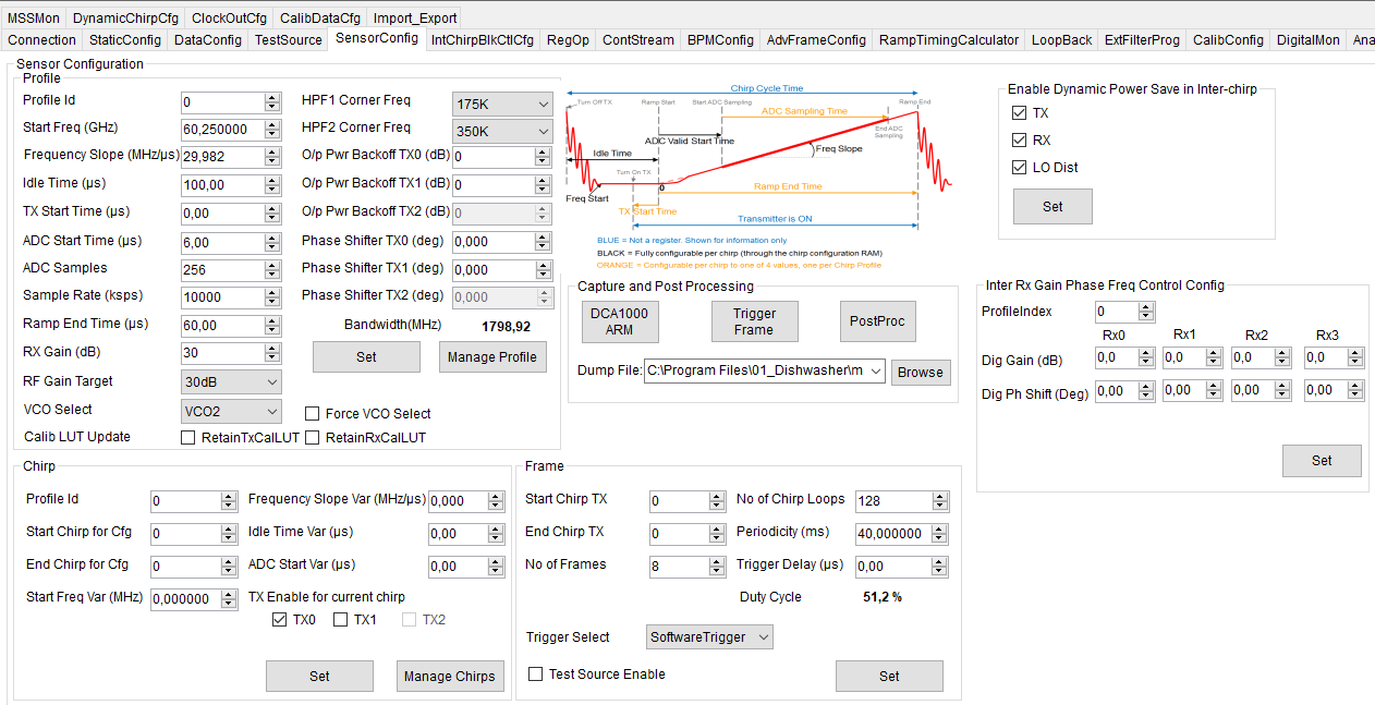

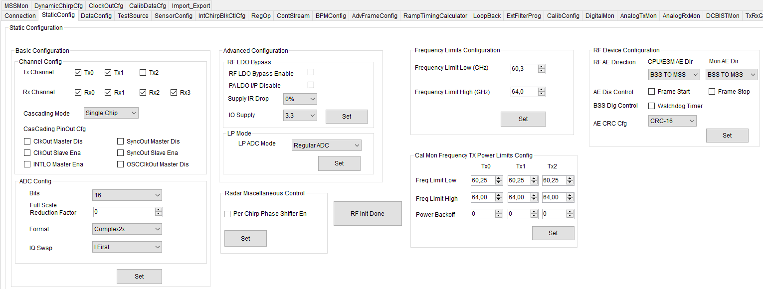

My best guess is that I am somehow using the wrong data or chirp configuration, so I am attaching pictures of those:
See also the Output of the Terminal of mmWave Studio:
[09:28:02]  ***Script completed successfully.***

[09:28:13]  [RadarAPI]: ar1.Connect(16,115200,1000)
[09:28:14]  [RadarAPI]: ar1.Calling_IsConnected()
[09:28:15]  [RadarAPI]: ar1.SelectChipVersion("IWR6843")
[09:28:15]  [RadarAPI]: Status: Passed
[09:28:15]  [RadarAPI]: RS232 is not connected ..!!!!
[09:28:15]  [RadarAPI]: ar1.frequencyBandSelection("60G")
[09:28:15]  Device Status : IWR6843/QM/SOP:2/ES:1
[09:28:16]  [RadarAPI]: ar1.SelectChipVersion("IWR6843")
[09:28:16]  [RadarAPI]: Status: Passed
[09:28:16]  Device Status : IWR6843/QM/SOP:2/ES:1
[09:28:16]  [RadarAPI]: ar1.SaveSettings('C:\Users\trittlert\AppData\Roaming\RSTD\ar1gui.ini')
[09:28:22]  [RadarAPI]: ar1.DownloadBSSFw("C:\\Program Files\\01_Dishwasher\\mmwave_studio_02_00_00_02\\rf_eval_firmware\\radarss\\xwr68xx_radarss.bin")
[09:28:22]  [RadarAPI]: Downloading BSS ROM RPRC Binary..
[09:29:05]  [RadarAPI]: ar1.GetBSSFwVersion()
[09:29:05]  [RadarAPI]: BSSFwVersion:(06.00.05.00 (01/08/18))
[09:29:07]  [RadarAPI]: ar1.DownloadMSSFw("C:\\Program Files\\01_Dishwasher\\mmwave_studio_02_00_00_02\\rf_eval_firmware\\masterss\\xwr68xx_masterss.bin")
[09:29:07]  [RadarAPI]: Downloading MSS RPRC Binary..
[09:29:55]  [RadarAPI]: ar1.PowerOn(0, 1000, 0, 0)
[09:29:55]  [RadarAPI]: Status: Passed
[09:29:55]  MSS power up done async event received!
[09:29:58]  [RadarAPI]: ar1.RfEnable()
[09:29:58]  BSS power up done async event received!
[09:29:58]  [RadarAPI]: Status: Passed
[09:29:59]  [RadarAPI]: ar1.GetBSSFwVersion()
[09:29:59]  [RadarAPI]: BSSFwVersion:(06.00.05.00 (01/08/18))
[09:30:26]  [RadarAPI]: ar1.ChanNAdcConfig(1, 1, 0, 1, 1, 1, 1, 2, 2, 0)
[09:30:26]  [RadarAPI]: Status: Passed
[09:30:27]  [RadarAPI]: ar1.LPModConfig(0, 0)
[09:30:27]  [RadarAPI]: Status: Passed
[09:30:28]  [RadarAPI]: ar1.RfInit()
[09:30:28]  RF Init async event received!
[09:30:28]  [RadarAPI]: Time stamp, Temperture: 30079,51; APLL Status, Update: 1, 0; SynthVCO1 Status, Update: 1, 1; SynthVCO2 Status, Update: 1, 1; LODist Status, Update: 1, 1; RxADCDC Status, Update: 0, 0; HPFcutoff Status, Update: 0, 0; LPFcutoff Status, Update: 0, 0; PeakDetector Status, Update: 0, 0; TxPower Status, Update: 0, 0; RxGain Status, Update: 0, 0; TxPhase Status, Update: 0, 0; RxIQMM Status, Update: 0, 0;
[09:30:28]  [RadarAPI]: Status: Passed
[09:30:32]  [RadarAPI]: ar1.DataPathConfig(513, 1216644097, 0)
[09:30:32]  [RadarAPI]: Status: Passed
[09:30:33]  [RadarAPI]: ar1.LvdsClkConfig(1, 1)
[09:30:33]  [RadarAPI]: Status: Passed
[09:30:34]  [RadarAPI]: ar1.LVDSLaneConfig(0, 1, 1, 0, 0, 1, 0, 0)
[09:30:34]  [RadarAPI]: Status: Passed
[09:30:38]  [RadarAPI]: ar1.ProfileConfig(0, 60,25, 100, 6, 60, 0, 0, 0, 0, 0, 0, 29,982, 0, 256, 10000, 0, 131072, 30)
[09:30:39]  [RadarAPI]: Status: Passed
[09:30:44]  [RadarAPI]: ar1.ChirpConfig(0, 0, 0, 0, 0, 0, 0, 1, 0, 0)
[09:30:44]  [RadarAPI]: Status: Passed
[09:30:47]  Test Source Already Disabled...!!!
[09:30:47]  [RadarAPI]: Status: Passed
[09:30:47]  [RadarAPI]: ar1.FrameConfig(0, 0, 8, 128, 40, 0, 1)

[09:31:11]  [RadarAPI]: Packet Reorder Utility Started...please wait...
[09:31:11]  [RadarAPI]: ar1.PacketReorderZeroFill("C:\\Program Files\\01_Dishwasher\\mmwave_studio_02_00_00_02\\mmWaveStudio\\PostProc\\adc_data_Raw_0.bin", "C:\\Program Files\\01_Dishwasher\\mmwave_studio_02_00_00_02\\mmWaveStudio\\PostProc\\adc_data.bin", "C:\\Program Files\\01_Dishwasher\\mmwave_studio_02_00_00_02\\mmWaveStudio\\PostProc\\pktlogfile.txt")
[09:31:16]  [RadarAPI]: Packet Reorder Utility process completed!
[09:31:31]  [RadarAPI]: ar1.StartMatlabPostProc("C:\\Program Files\\01_Dishwasher\\mmwave_studio_02_00_00_02\\mmWaveStudio\\PostProc\\adc_data.bin")
[09:31:31]  [RadarAPI]: Error:
[09:31:31]
[09:31:31]  ... MWMCR::EvaluateFunction error ...
[09:31:31]  19-Nov-2019 09:31:31: The file C:\Program Files\01_Dishwasher\mmwave_studio_02_00_00_02\mmWaveStudio\PostProc\adc_data.bin is empty. Please capture more data.,1,
[09:31:31]  Error in => process_adc_data.m at line 52.
[09:31:31]
[09:31:31]  ... Matlab M-code Stack Trace ...
[09:31:31]      at
[09:31:31]  file C:\Users\TRITTL~1\AppData\Local\Temp\TrittlerT\mcrCache8.5.1\Matlab0\Logging\log_status.m, name log_status, line 32.
[09:31:31]      at
[09:31:31]  file C:\Users\TRITTL~1\AppData\Local\Temp\TrittlerT\mcrCache8.5.1\Matlab0\Processing_functions\read_adc_data.m, name read_adc_data, line 28.
[09:31:31]      at
[09:31:31]  file C:\Users\TRITTL~1\AppData\Local\Temp\TrittlerT\mcrCache8.5.1\Matlab0\MatlabPostPr\process_adc_data.m, name process_adc_data, line 52.
[09:31:31]
[09:31:31]
[09:31:31]  Trace:
[09:31:31]     bei MathWorks.MATLAB.NET.Utility.MWMCR.EvaluateFunction(String functionName, Int32 numArgsOut, Int32 numArgsIn, MWArray[] argsIn)
[09:31:31]     bei MathWorks.MATLAB.NET.Utility.MWMCR.EvaluateFunction(Int32 numArgsOut, String functionName, MWArray[] argsIn)
[09:31:31]     bei MatlabPostProcGui.MatlabPostProcGUIClass.process_adc_data(MWArray adc_file_name, MWArray force_cont_stream_mode)
[09:31:31]     bei AR1xController.frmAR1Main.iStartCaptureMtlabPostProc()
