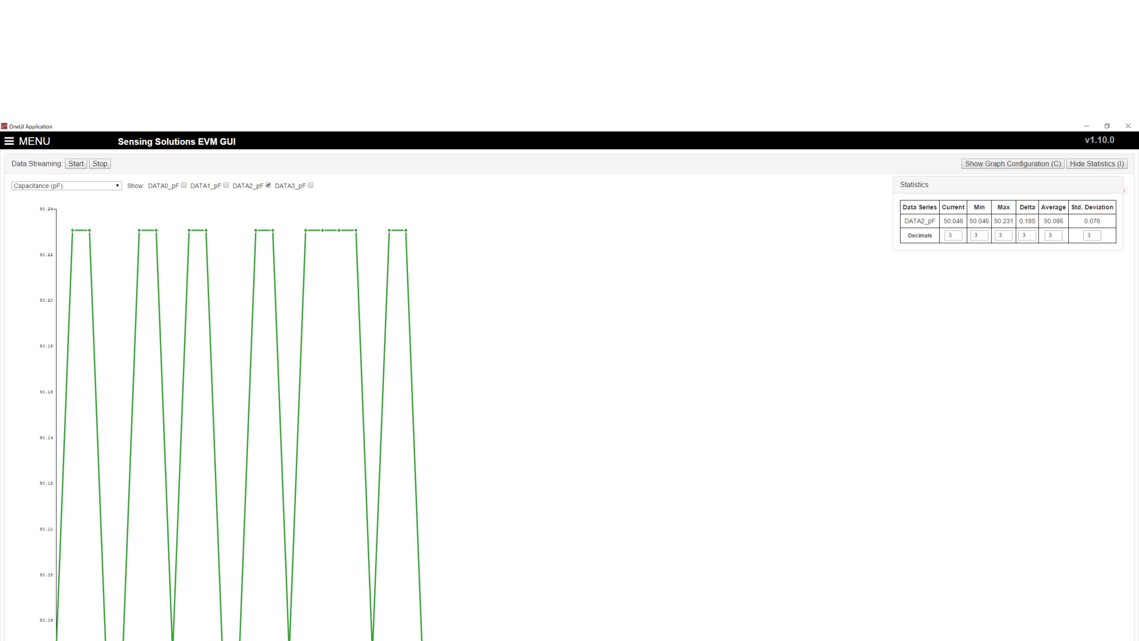

When measuring using [Data Streaming] of GUI
It shows 53pF when not touching the sensor, and 0.1 ~ 0.5pF capacitance increases when touching from outside.
My concern is that the sensor is reacting, but this 0.1 ~ 0.5pF is probably too small.
Can you tell me because I don't know if it's weak?

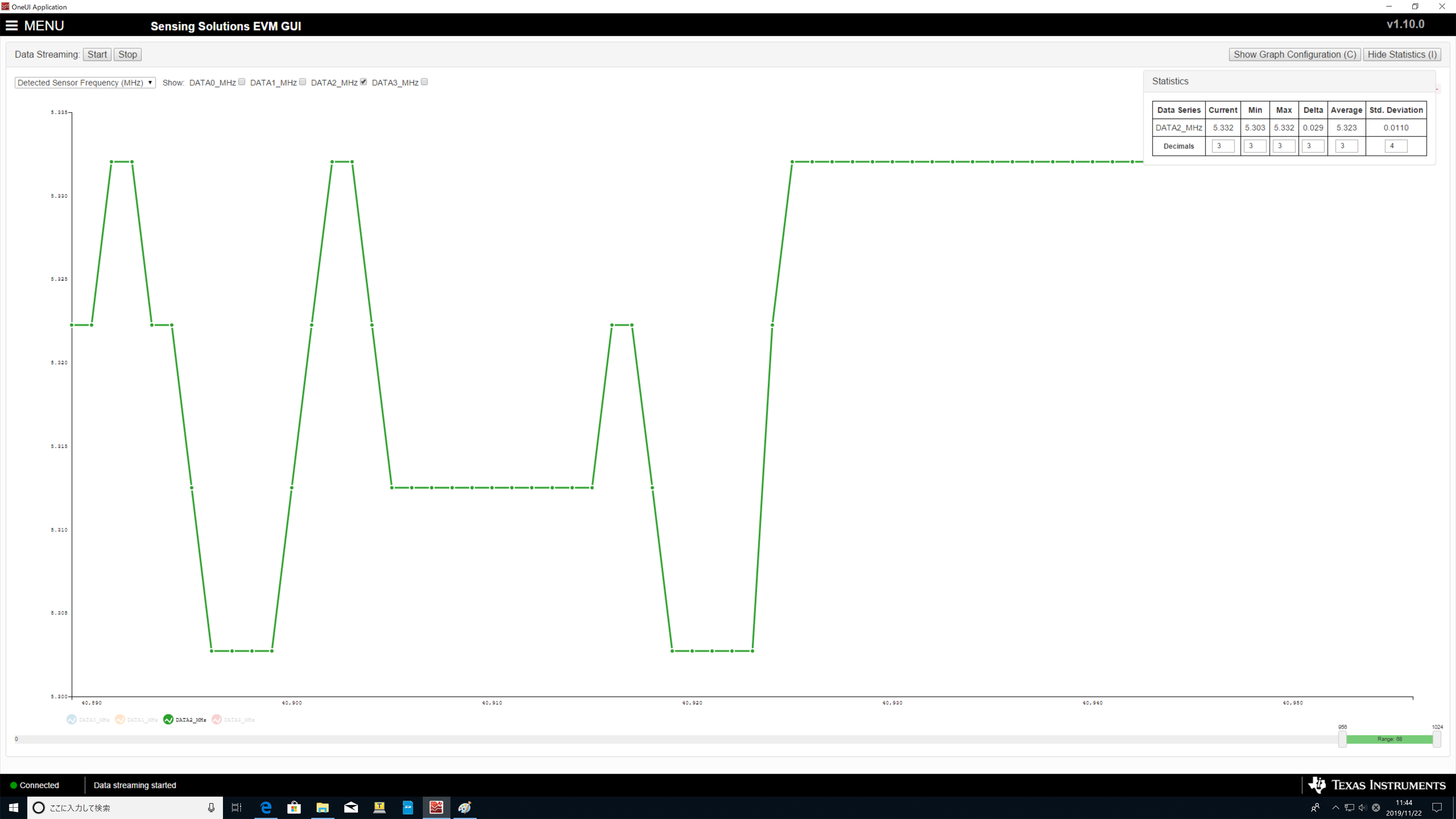

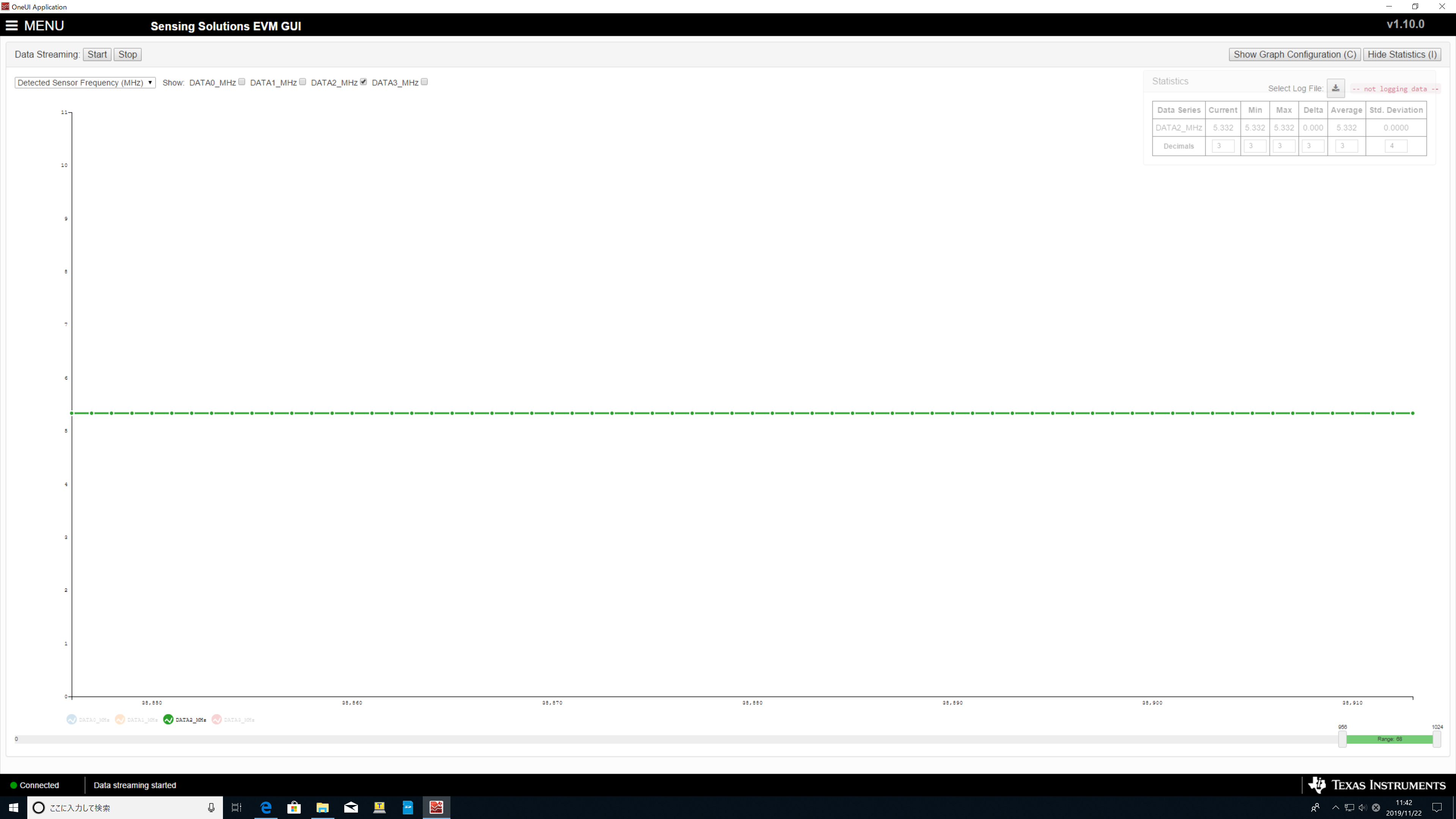

    Regarding Step 3 [Detected Sensor Frequency], the value is 5.332MHz when not touched, and the graph below shows when touched.
    There are three questions.
    ① What does the noise floor mean?
    Is this Detected Sensor Frequency related?
    ② If the standard deviation is 3 times, will the noise floor value be 1 based on this graph?
    ③ Where should I check if the SNR is 10?
    I would appreciate your reply.
    < 1:touch 2:no touch>
    1. The noise floor is the measured changes in the sensor frequency without the target present. The noise can come from a variety of sources, including aggressor signals within the sensor's passband, changes in temperature that cause changes in sensor inductance or capacitance, and quantization noise.
    2. You should use the second graph, where there are no touches on the sensor. You also need to increase the number of decimal places of your Std Deviation measurement. Once you have a non-zero number in the Std Deviation column, use 3 times this number.
    3. In graph 1, your signal magnitude is the difference between the default sensor frequency and the sensor frequency when you touch the sensor. Use this to calculate the SNR.

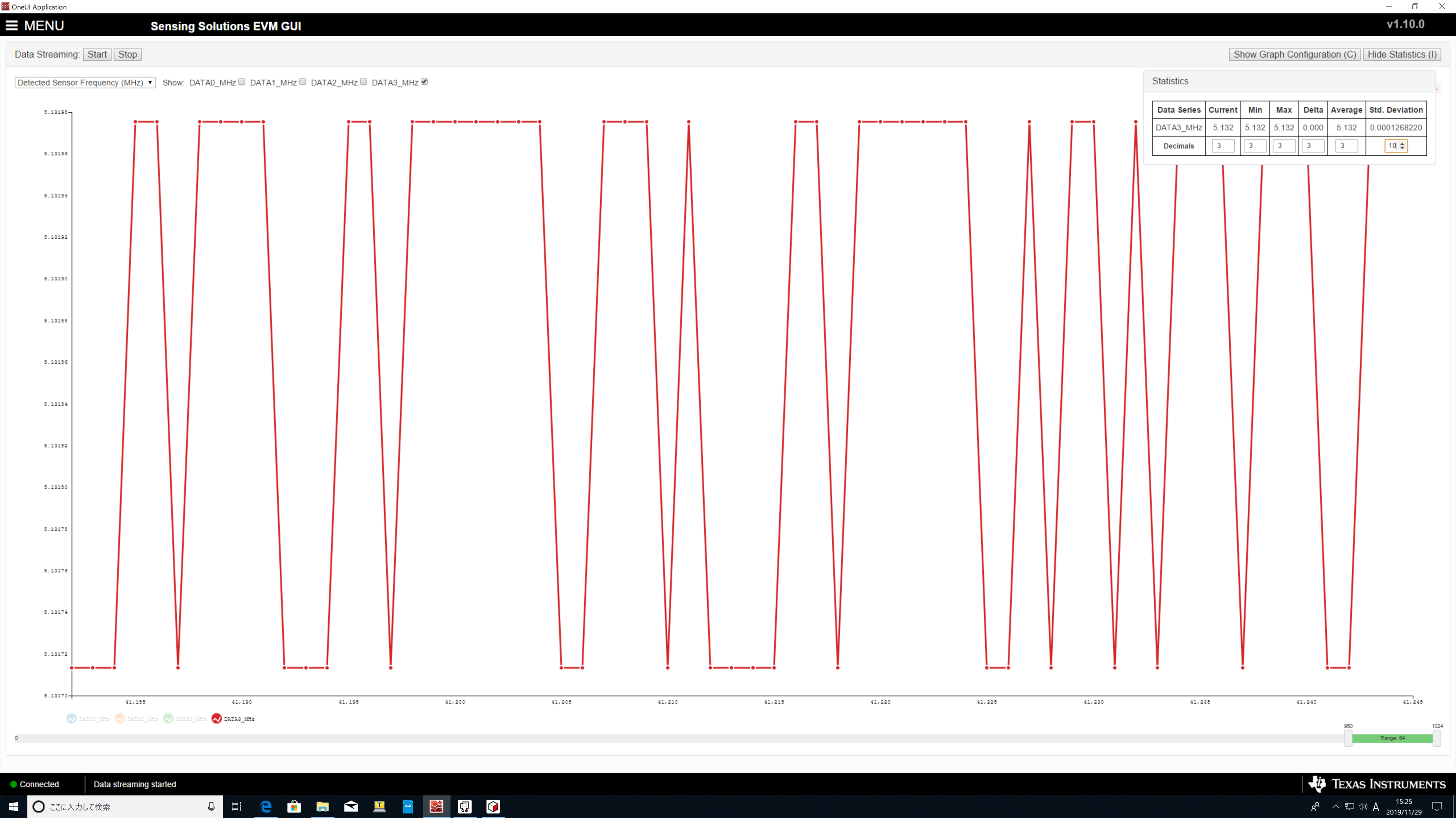

    2. I checked you instructed again (Please see the chart below). I can't understand yet what you said "use 3 times this number".
       What use number??

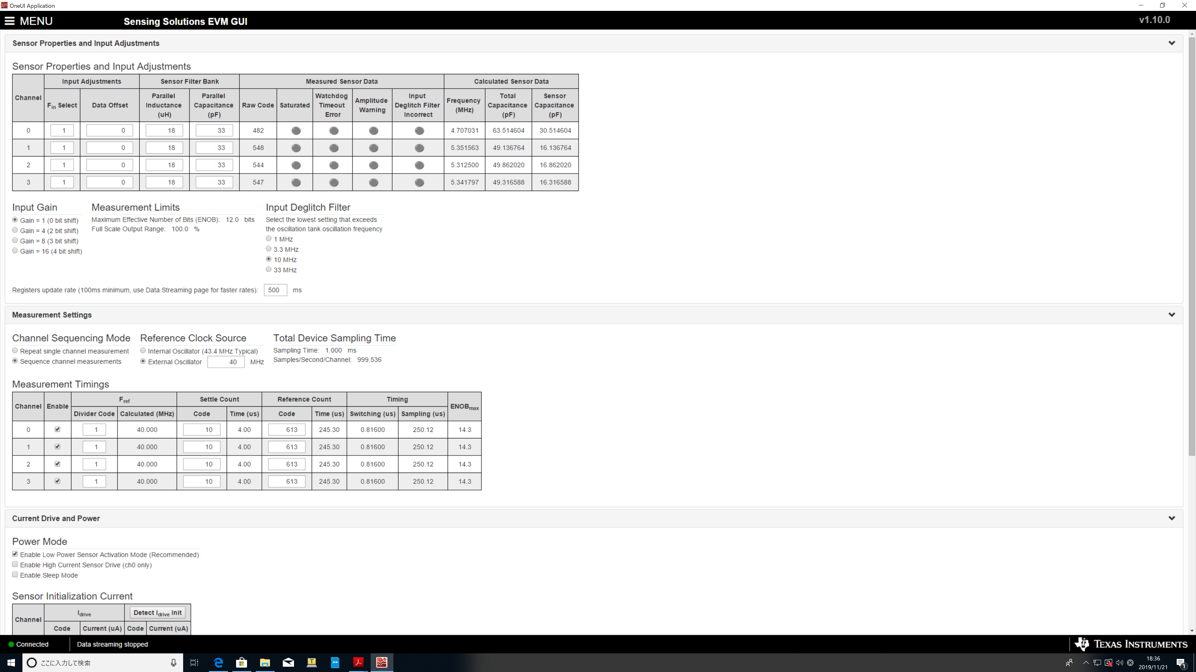

    3.Is the default value of the sensor correct with the value set in “Configuration” of the GUI?
      Could you tell me the specific SNR calculation method?
      It may be common sense, but I am happy if you can tell me because I don't have enough knowledge.
    <touch /no touch sensor>
    Thanks for your patience while I was out for the Thanksgiving holiday.
    2. Use the number right under "Std. Deviation." In your no touch image, this number is ~0.000126MHz, or ~126Hz. Use 3*126Hz = 378Hz as your noise floor.
    3. SNR = (signal magnitude) / (noise floor) = ( (sensor frequency before touch) - (sensor frequency after touch) ) / 378Hz

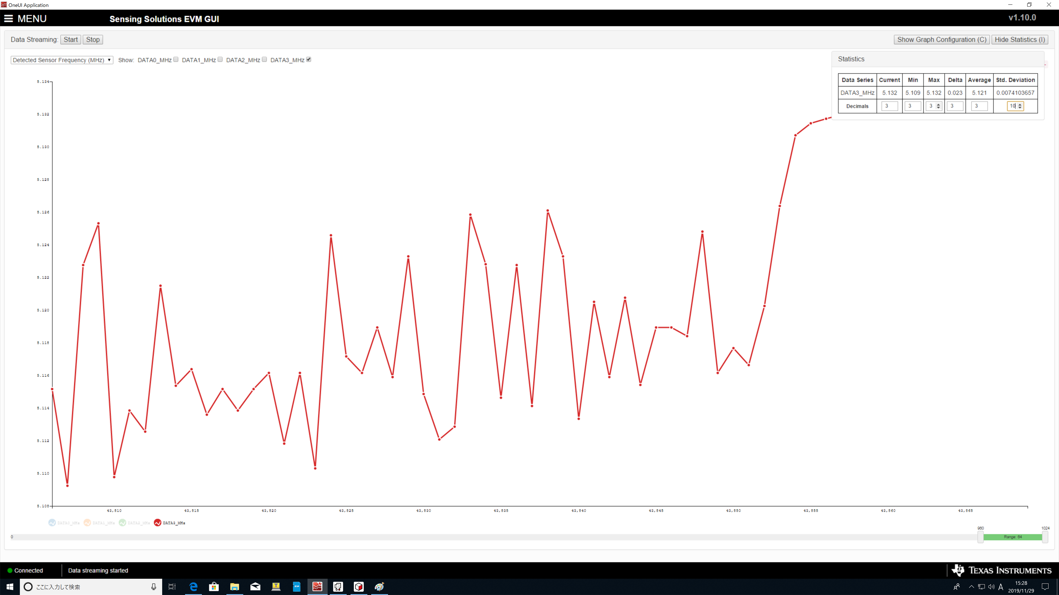

       Actually,I calculated .
    (sensor frequency before touch) = 5.122MHz
    (sensor frequency after touch)       =   5.152MHz
    SNR = (5.122MHz - 5.152MHz ) / 378Hz = 79.365...
    Since the SNR is at least 10, is there any problem with the sensor response?
    Masato
  • Hello Masato,
    No, there is no problem with your sensor response. You have a very good SNR.
