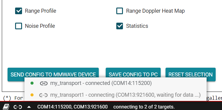

I launch the mmWave visualiser at https://dev.ti.com/gallery/view/mmwave/mmWave_Demo_Visualizer/ver/3.3.0/ (it has already installed the add-ons to my Chrome browser in previous attempts)
I close the pop up text box window, I select "xWR68xx" for the platform, and set the SDK version to "3.3"
I go to Options -> Serial Port and select COM14 as CFG_port and COM13 as DATA_port (see COM port allocations above)
On the main screen, at the bottom corner I get the following:
- COM14 is connected.
- COM13 never connects and just stays as "waiting for data" indefinitely
- Pressing "SEND CONFIG DATA TO DEVICE" does nothing and no output is sent to the visualizer console, no information is plotted on the plot panes either.
This seems to be a common issue looking at other help threads and one which none of the previous threads seem to offer a consistent fix.
I have been through the process of pressing the NRST switch at various stages etc. Nothing helps.
What should I be doing differently?
