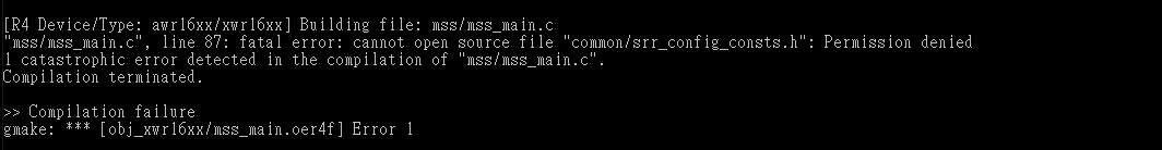

Hi sir,
I download the "lab0002_short_range_radar" source code and I try to compile in my PC.
But It always has the problem about some header file cannot open.(Show as below)
And I had already install the "mmwave_sdk_02_00_00_04" and "CCS9.1.0" in the C:/ti.
Please help to clarify this problem A.S.A.P
BR
Frank
  • Ps. My compile path is "C:\ti\mmwave_sdk_02_00_00_04\packages\ti\demo\xwr16xx\lab0002_short_range_radar\src>"

  • CCS is OK but I want to copy the "common folder" to "dss/common" and "mss/common" by makefile.

    In order to build the demo with makefiles,
    I recommend you follow the structure of the mmWave SDK 2.0.0.4 demo.
    You should create a folder "srrdemo" as follows and copy the demo folders inside. You will need to follow the makefile structure of the SDK demo
    C:\ti\mmwave_sdk_02_01_00_04\packages\ti\demo\xwr16xx\srrdemo
