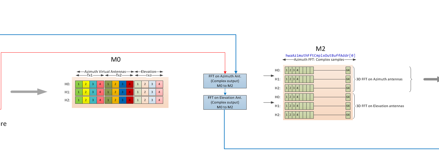

    I have watched the training series. In the AoA document, for azimuth FFT, it looks like
    There are 12 virtual antennas in total, and for Tx1 and Tx2 there could be 8 virtual antennas to perform azimuth FFT. I was wondering how come that the number of complex samples is 64 after the azimuth FFT? and also for Elevation Ant. why the number of complex samples is also 64? Could you please tell me the detailed implementation of this part?
    Thank you very much!
    Peijun Zhao
  • Because angle inputs are very few (8/12 for Ntx = 2/3), it results in poor accuracy of estimation if you try to do a smaller FFT, a bigger FFT basically interpolates with zero padding. The resolution - smallest angle separation between two objects simultaneously present in the seen to be able to see two distinct peaks in the spectrum is still determined by the number of virtual antennas in the case of this algorithm for angle estimation  and is 2/Nvirtual radians i.e you cannot improve resolution by doing a bigger FFT but you can improve accuracy. You can also use other interpolation methods but FFTs are cheaper in HWA/DSP. Accuracy will ultimately be limited by SNR.
    Regarding question 3), in general angle FFT can be done post 1D FFT as the angle is along the spatial dimension [Rx-es], not the slow time (doppler) dimension but for TDM-MIMO, you have to do doppler compensation before you do angle FFT on the virtual antennas and to do doppler compensation you have to do doppler estimation i.e doppler FFT first. Also, in our processing chain, we do CFAR on range-doppler and perform angle computation only on the points detected by the CFAR.
