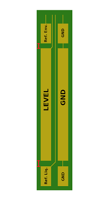

    Thank you for your answer. We're now on to designing our first flex-PCB sensor prototype, for use with the FDC1004 and single-ended measurements. I have some questions regarding the reference electrodes:
    1. See the attached sketch, which is not to scale when it comes to lengths and widths, but only meant to show the sensor layout. You can see that I have placed the liquid and environmental reference electrodes beneath and above the level sensor itself, in an effort to minimize the total width of the flex-PCB. The liquid level would always be above the height of the Liquid reference sensor. Is this an OK layout from your perspective, or is there anything wrong with putting all the sensors "on one line" like this?
    2. I understand that the liquid and environmental sensors should be equally sized. Is there any rule of thumb for their minimum height?
    3. Shielding: Would it work well to use one large shield covering the entire bottom layer of the PCB, or should I use six separate shield patches, covering each of the six electrodes?

  • Hi Lars,
    My apologies for the delayed reply; I was out for the Thanksgiving holiday. I've answered your questions below:
    1. I don't see a problem with having all of the sensors in one line. The only thing I'd recommend changing is the trace to the reference liquid electrode. This runs quite a long distance next to the GND electrode, so your reference capacitance may change as the liquid level rises. You could either route this trace on the other side of the level electrode or you could add a shield trace in between the reference liquid trace and the GND electrode.
    2. I would keep the height at least 1cm.
    3. You can use a single copper pour, but I suggest only shielding the reference and level electrodes, not the GND electrodes. The GND electrodes do not need to be shielded and will needlessly load the shield driver, which can only drive up to 400pF.

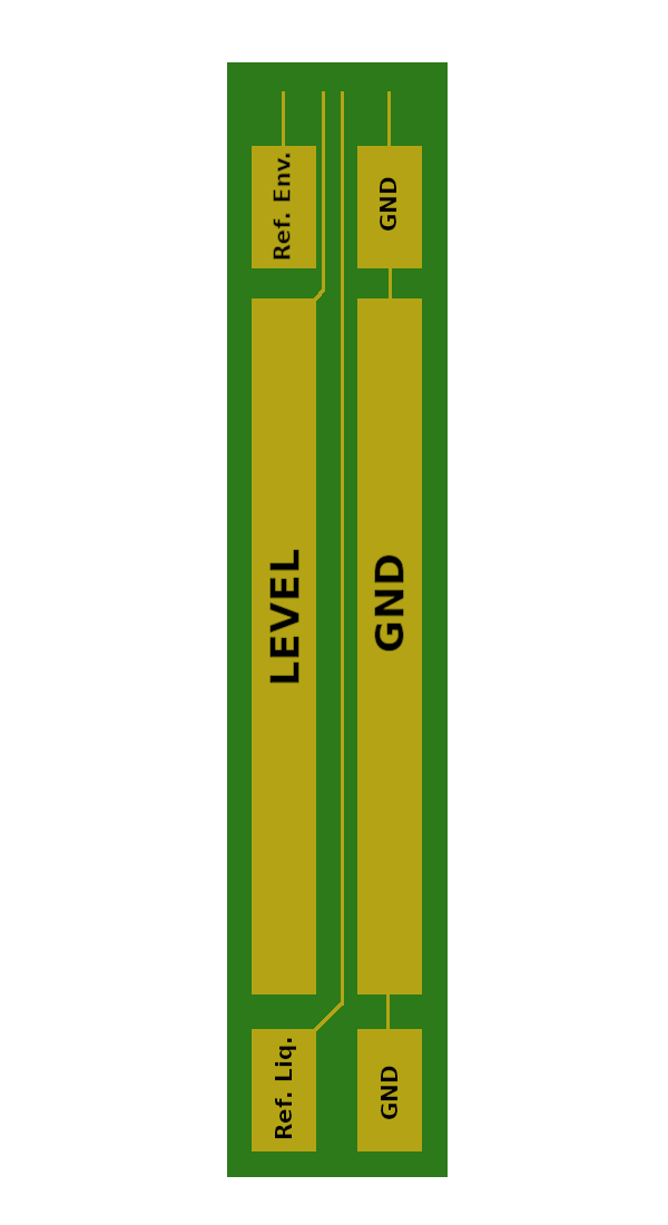

  • Hi Kristin,
    Thank you for good answers. One more question: Are there any best-practices regarding the gap between the Level and reference sensors (marked in red in the drawing below)?

  • Hi Lars,
    Apologies for the delay; I was out of office for part of last week. I don't have any best practices for this sensor spacing because our experiments were done using the sensors in TIDU-736a.
    However, note that any space there will be a "dead zone" where the level sensor will not be able to detect any liquid. This layout does prevent you from being able to detect all the way to the bottom of the container. The minimum detectable level will be at the bottom of the level sensor.
