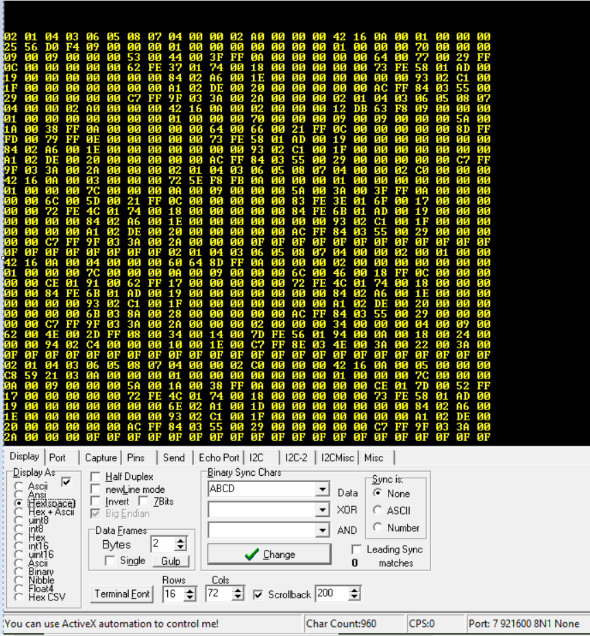

I can see the objects in the GUI. I am trying to read the data (Real term application with baud rate of 921600) using MSS LOGGER port, but I did not really short R26, Instead I am trying to read data from R26 itself. I can see the data as some hex numbers.
I am using gui Monitor Configuration as 1 1 0 0, with this configuration I should get data like FRAME Header + TLV (Detected Objects) + TLV (Clusters) .
But when I am trying to analyse it does not look the same. Please find the attached file.
Is MSS LOGGER is the correct port to read the data?
How Can I really use this data? Like I want the exact position of an object, How Can I get that position from the above data?

    Regarding the format of the output data, please see the User Guide.Once you detect the magic number, you should be able to understand the content of the data.

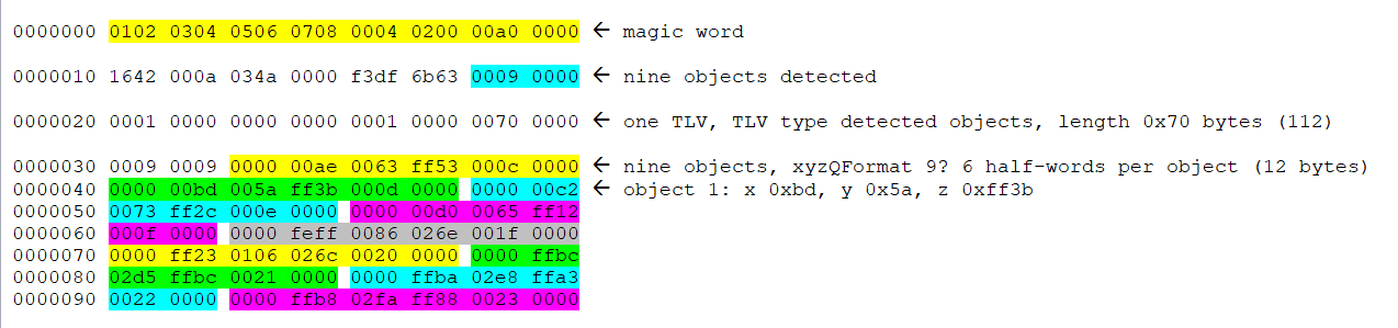

    The (x,y,z) is provided in Q9 format. So you will have to scale the integer data by 2^9=512
    Please also see attached snapshot that may help
    Here is the matlab code that performs this operation in the gui

    Before I used to work with ODS_DEMO example on AWR1843BOOST board and the output data format is as shown below.
