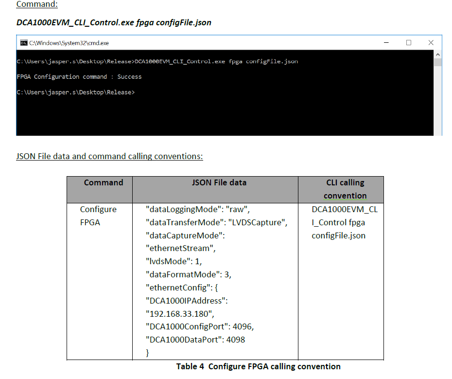

    You can change IP, MAC address and both of ports of DCA100EVM using cli exe using below command and new network detail should be set under 'ethernetConfigUpdate' of json file.
    DCA1000EVM_CLI_Control.exe eeprom dca1000_config.json
    Make sure while capturing the data you set new network details under 'ethernetConfig' tag of json file.

    For example, I discovered the follow description:
    "Multiple instances of the CLI_Control tool can be instantiated on the PC to control multiple EVMs while using unique UDP Ports for each EVM."
    How to understand "unique UDP Ports" ?  Is the data port of PC in the UDP protocl?
    Does it mean CLI_Control tool can control multiple DCA1000EVMs by only set IP, MAC address and both of ports?
    And does it mean CLI_record tool can recieve data from multiple DCA1000EVMs?

    Connecting and communicating multiple DCA1000EVM from single PC was not primary requirement/use-case of this board and CLI_control tool.
    Although you can do that by using different network detail of DCA1000EVM. (your understanding is correct : yellow marked line above).
    As I mentioned in last reply with eeprom command and with different IP, config & Data port in *.json file you can change the network setting of DCA1000EVM. Then on the PC while communicating to DCA1000EVM you need to use latest network info.
    I tried above step at my end with a single DCA1000EVM and I was able to communicate with board with different IP and ports.
    To connect with two boards you need to have two ethernet connection on the PC (second one can be added using USB convertor) and have access to both of the IP address at a time.
    you can execute two instances of CLI_control.exe with different cf.json file having different network info of DCA1000EVM. You need to use different IP addresses and config & data Port for both of DCA1000.
