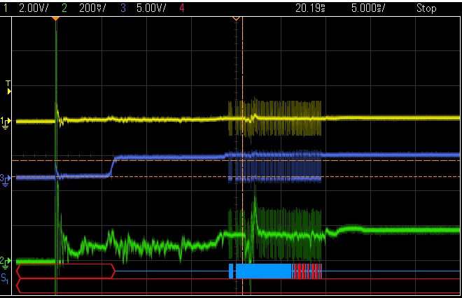

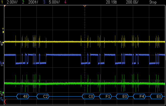

I have noticed that when I power up the IWR1443 board, there is some UART communication that occurs before the micro starts.  Specifically, the IDE is in the debug mode and debug firmware is loaded into the IWR1443 board, but before the target configuration is launched in the IDE.  When power is applied to the board, the UART associated with the data port (IWR1443 Pin R5) sends out about 10 ms of data at what appears to be 57.6 kb/s.
Where is this data coming from in the code?
What is the purpose?
Can it be removed from the debug build?
Will it occur in a production build of firmware?

  • Hi Nitin,
    I was seeing it on the logging UART.  That's the one that is set up in the MmwDemo_initTask() function of main.c.
        /* Open the Logging UART Instance: */
        gMmwMCB.loggingUartHandle = UART_open(1, &uartParams);
        if (gMmwMCB.loggingUartHandle == NULL)
            System_printf("Error: Unable to open the Logging UART Instance\n");
            return;
          System_printf("Debug: UART Instance %p has been opened successfully\n", gMmwMCB.loggingUartHandle);
    When the system starts up, the print message says that the Instance is @0800ad08.
    Alan
  • Hi Alan,
    Thanks for the information. This output is coming from the debug logging in MSS bootloader and this logging is always enabled in the bootloader. Could you please clarify what is the application level concern with this output? The UART peer entity should be able to ignore it.
    -Nitin
  • Hi Nitin,
    The application level concern is one of total power consumption.  We are building a device that will work on a 4-20mA loop, so that the total power budget is on the order of 50 mW.  To make that work, we will have to store power in some super capacitors.  Most likely, we will have to shut down the IWR1443 and PMIC after a set of radar measurements in order to charge the caps back up.  Therefore, each time a measurement is to be made, the IWR1443 will go through its bootup sequence.  The shorter that sequence, the less power consumed over a measurement cycle.  The UART output in question takes about 10 ms.  That's a significant portion of the startup time.  So if there's a way to eliminate it, it would save quite a bit of power.
