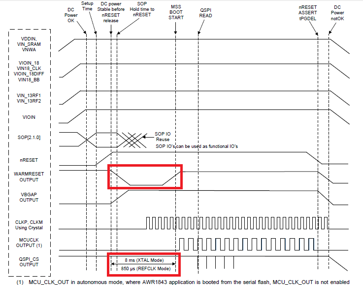

From AWR1843 datasheet, it looks the WARMRESET OUTPUT low duration shall be longer than 8ms like below.
If the duration is less than 8ms, (for example, only 7ms) will it impacts the device booting?
Customer have few percentage AWR1843 board which are not booting. QSPI NOR flash is no activity, not loading image from flash to RAM.
From measurement, the WARMRESET OUTPUT low duration between normal board and abnormal board is a little bit different.
That's why we're asking this question.
