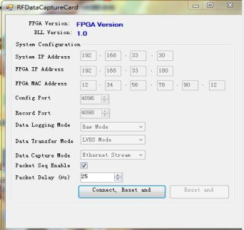

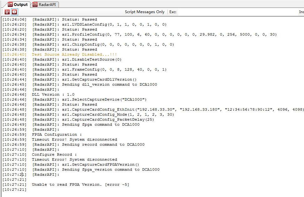

I've followed the mmWaveStudio user guide,DCA1000EVM Data Caputure Card user guide and the DCA1000 training video very strictly. As the user guides and training video show, there were no previous issues including the Ethernet connection mentioned in the forum, but when I tried "SetUp DCA1000", I received the following error message:Timeout Error! System disconnected and then it shows Unable to read FPGA Version. [error -5].
I have browsed and tried some of the solutions mentioned before in the forum, but it didn't work. At the same time I noticed that the FPGA DLL version of the user guide and some forum postings is 2.7 but the FPGA DLL I show here is 1.0. Will this difference cause problems?
But when I tried on my colleague's desktop, the FPGA DLL version was also displayed as 1.0, but there was no "Timeout Error! System disconnected and then it shows Unable to read FPGA Version. [Error -5].".And finally the .bin file  can be generated correctly as trianing video shows.
So I'm weird and don't know why this happened, I hope someone gives me a solution so I can continue to enjoy the device.
Thanks very much!
Following are screenshots of the problem,

    Yes,I use the latest version of mmWaveStudio provided by the above link, which is the 02.01.00.00 version. The DCA1000 I use now was purchased online around October to November. Following is a screenshot of the shortcut of mmWaveStudio I use.
    And because my FPGA DLL version shows 1.0,it's different from the training videos and some of the posters,this also confuses me . Based on this fact, I also thought about whether the mmWaveStudio version does not match, so I also tried to download and use the previous version provided by the above link, which is 01.00.00.00 Version and this version is also used in the training video demo, but it still has these same problems I described.
    thanks.
  • I also have been unable to read the FPGA version using the DCA1000 connected through a boost board to a 6843.   Everything up to hitting the button "Set up DCA1000" looks good, but when I click that, I get :
    10:45:09] [RadarAPI]: ar1.CaptureCardConfig_EthInit("192.168.33.30", "192.168.33.180", "12:34:56:78:90:12", 4096, 4098)
    [10:45:11] ConnectRFDCCard Status: RRFDCCARD_SUCCESS
    [10:45:11] Ethernet Cable is disconnected Please check.....!!!
    Sometimes the FPGA version message pops up with the version being 0.0.0.0 - other times the version is just "FPGA version" or some error message.   I may try trying to redownload the FPGA code on the DCA1000     It is strange it says my ethernet is disconnected, because it does identify the DCA1000 IP address as being 192.168.33.180    I believe my computers ethernet port is working properly.   When I try to capture a frame, the files that do get created show as being 0 length.      I may try running all this on another computer.

  • I got a USB 2.0 ethernet adapter - and it allowed me to get past the ethernet not found error I had when I used the ethernet connection that came with my laptop.  (my laptop ethernet connection had worked fine on everything else).    But I found I still had a problem where I would get the FPGA version read back as 0.0.0.0 or "FPGA Version" or something clearly wrong.   I went through the directions on "FPGA programming" of section 9 of spruij4a.pdf to reprogram the FPGA - but sadly, I still have the same problem and I still get the message "Unable to read FPGA Version. [error -5]" in the log file.
