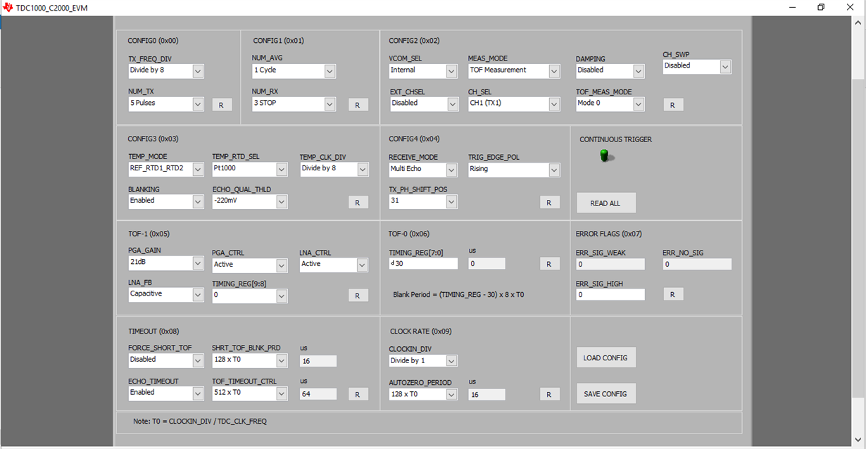

I am working with TDC1000_c2000EVM software and I am using STEMINC 1MHZ ultrasonic transducer. The transducer is mounted inside the small piece of steel with cyanoacrylate glue and mounted the steel on the top of the plastic container.
here is the problem
1. I am trying to measure the distance from the top. When I measure TOF with an empty (Air) condition, I got some values. On trying with some material inside the Jar, the TOF value is random. In some cases the TOF value displayed is that of empty. I am not getting TOF value corresponding to that of material. The readings are varying from time to time.

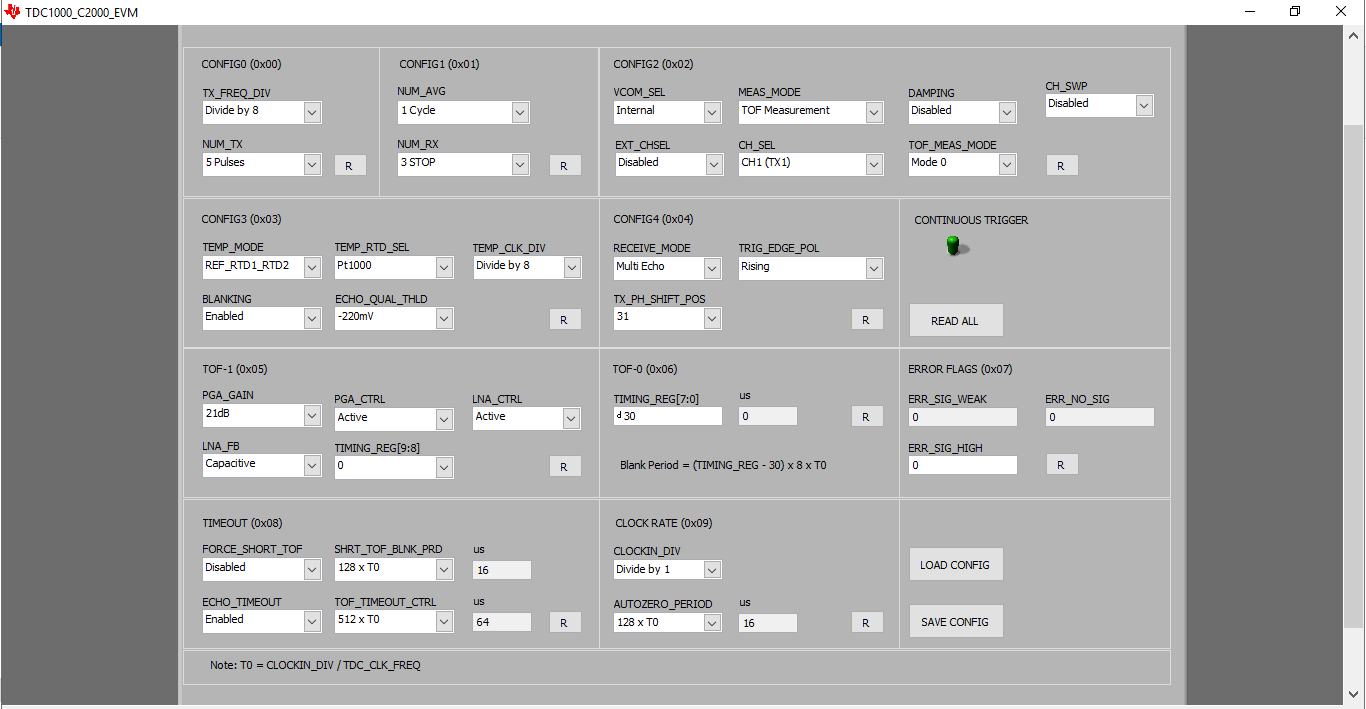

This is my configurations

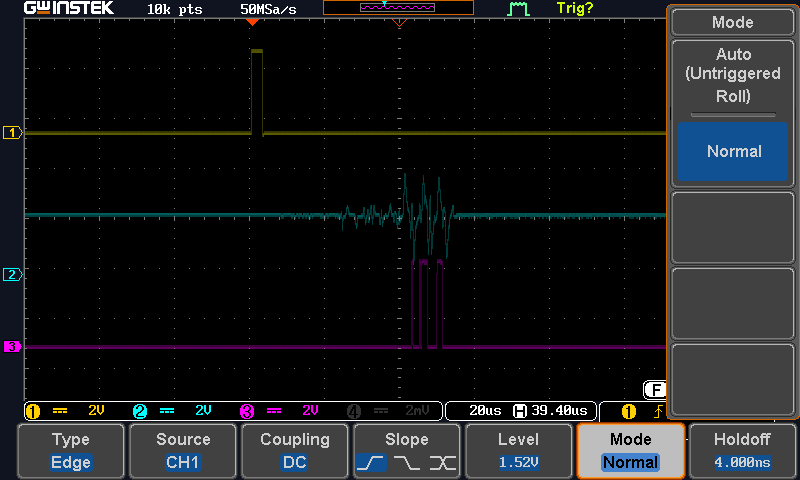

2. In oscilloscope, the time between the start and stop pulse is always 30-40us but in TDC1000_c2000evm software TOF value is around 550us when I enabled blanking the time is 30us+blanking period time.
Please review and share your suggestions.

    The 1Mhz transducer is typically meant for liquid sensing applications. For actual object or target applications I highly recommend a lower frequency transducers. I recommend reaching out to the transducer manufacturer and get guidance on the material selection for measuring different objects. Usually for high frequency transducers its meant for liquid coupled applications. As far as the settings are concerned I dont see any issues with the settings as per your screen shot.
    Here is the app note that discusses the transducer frequency http://www.ti.com/lit/an/slaa907a/slaa907a.pdf figure 11 specifically talks about the transducer selection for variations applications. For detecting materials in air a 400Khz or lower is highly recommended.
