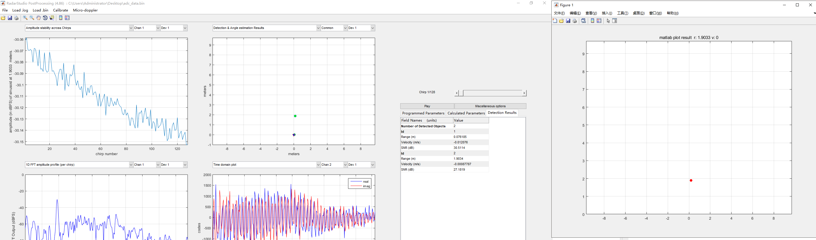

  • hi,thanks for replying
    1. There is no problem in range measurement and speed measurement from the raw data collected by DCA1000, but the angle measurement error is very large. Should I compensate the phase of the raw data?
    2. If yes, how should I compensate the phase of each channel on matlab? (like  Wn ?)
  • For example, I simulated an object with x = 2 and y = 2 with TestSource of mmWave Studio.
    When plotting through PostPro of mmWave Studio, it was in the correct position.
    But,in my own post processing in matlab ,I don't get the desired result;
    I want to know what PostProc did to the raw adc_data, or to correct it;

  • hi Zigang
    1. sorry,i mean i get the same result in my matlab script (generated by test source of mmwave studio);
    2. when i process the adc data from a real target , i can't get the correct angle (range and velocity are correct );
    3. post processing in mmwave studio did not do any preprocess ,is this right?

  • HI,
    It seems that you just confirmed that you get the same result with radar studio post processing vs. your MATLAB script.  Can you confirm?
    If you can not get accurate angle estimation, then you need to do a phase compensation for the device.

  • HI,
    If you are using DCA1000, you can place a strong corner reflector (CR) at zero azimuth and zero elevation angle.   Carefully setup the scene so that there is no other objects in the similar range bin other than CR.
    In this case, ideally the phase for all 12 virtual antenna should be all the same for the CR range bin.   If not, then it should be compensated to make the phase the same.  And this compensation can be used later for any capture.
