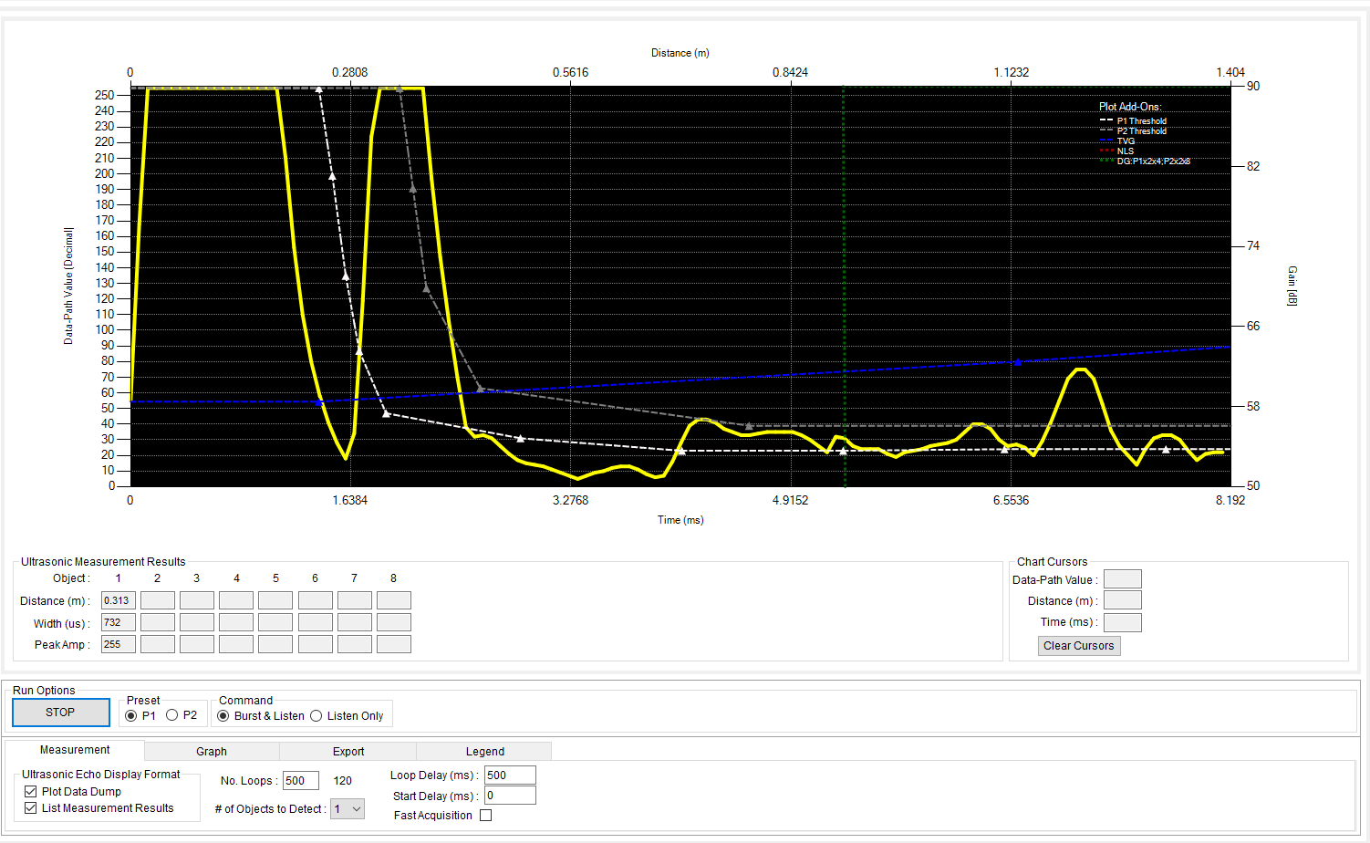

We are testing the product and some customers have reported that the sensor is oscillating the distance value when the obstacle is near. As we use the closed type sensor, I know that detection for distances less than 30cm is complicated, would there be any way to solve this distance value variation when the obstacle is near (<30cm)? Doing some tests here on the bench, I identified the following situation:
1 - Obstacle is physically at 70cm:
2 - Obstacle is physically 30cm:
3 - Obstacle is physically at 20cm:
Note that in this case the distance begins to vary (is reporting >80cm).
  • Hi Jonatan,
    Based on your last echo data dump waveform, the PGA460 is blind to the 20cm object because it is masked/absorbed by the burst-decay energy. Because the object does not exceed the threshold, the PGA460 will not be able to report sub-30cm measurements. The reason it reports a longer distance is because the echo bounces between the transducer and object multiple times, resulting in what appears to be a longer range echo detection.
    If you need reliable sub-30cm detection, you should use a higher frequency transducer, or reduce your time varying gain range from 58-90dB to 32-64dB with your existing transducer. Minimizing the gain will allow you to see more of the burst-decay to better wrap the threshold mapping and enable downwards of ~20cm short range detection.
