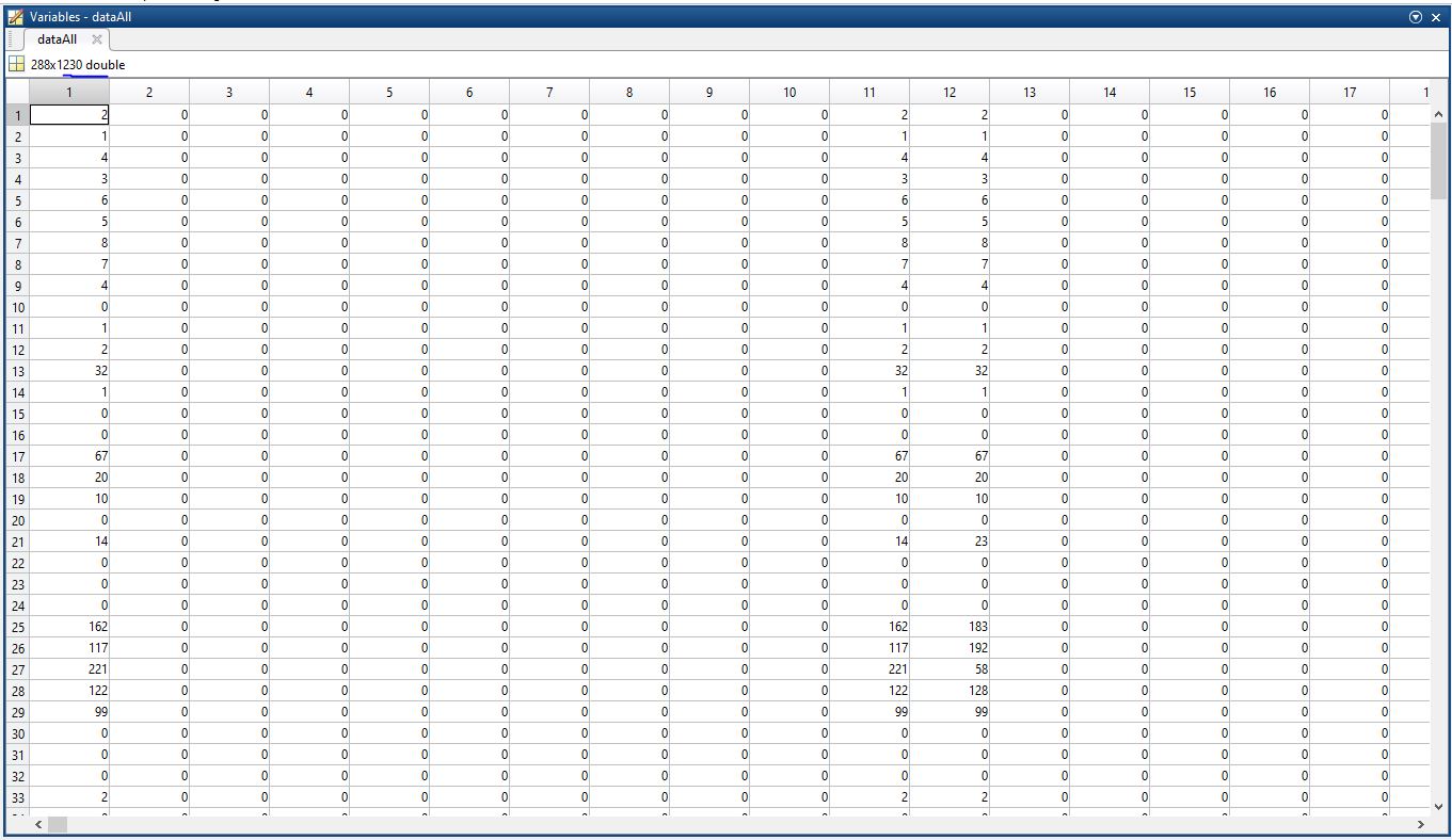

For the vital signs lab from mmwave_industrial_toolbox_4_1_0, I used the matlab file 'main_readGUISavedBinary.m' from mmwave_automotive_toolbox_2_7_1. Then, I had the same issue that from the other users posted in here: https://e2e.ti.com/support/sensors/f/1023/t/739935?tisearch=e2e-sitesearch&keymatch=%25252525252520user%2525252525253A352628
https://e2e.ti.com/support/sensors/f/1023/t/748737?tisearch=e2e-sitesearch&keymatch=vital%25252525252525252520sign%252525252525252525201443%25252525252525252520gui

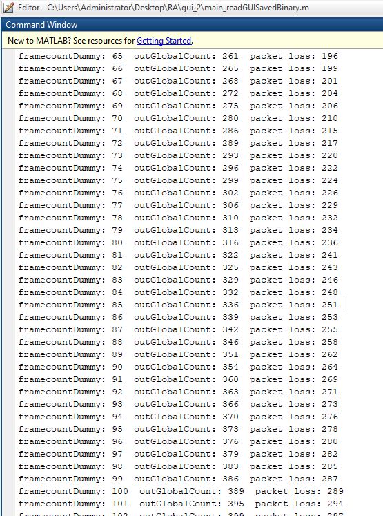

I tried to print out variable 'framecountDummy' from the GUI source file, it turns out that the value is not the same as 'outGlobalCount' from UART. It is also not the same as number of columns of 'dataAll' in 'main_readGUISavedBinary.m' file.
I don't know why this situation happens. Could you please help me?

    The data formats for the two demos are not the same.
    The matlab file 'main_readGUISavedBinary.m' must be updated to support vital signs lab from mmwave_industrial_toolbox_4_1_0.
    This can be done by checking the output data format for the demo included in the mmwave_industrial_toolbox_4_1_0.
    You would need to compare the file 'main_readGUISavedBinary.m'  with "mmwave_industrial_toolbox_3_6_1\labs\lab0002-vital-signs\lab0002_vital_signs_gui\vitalSigns_demo_gui.m" and update accordingly

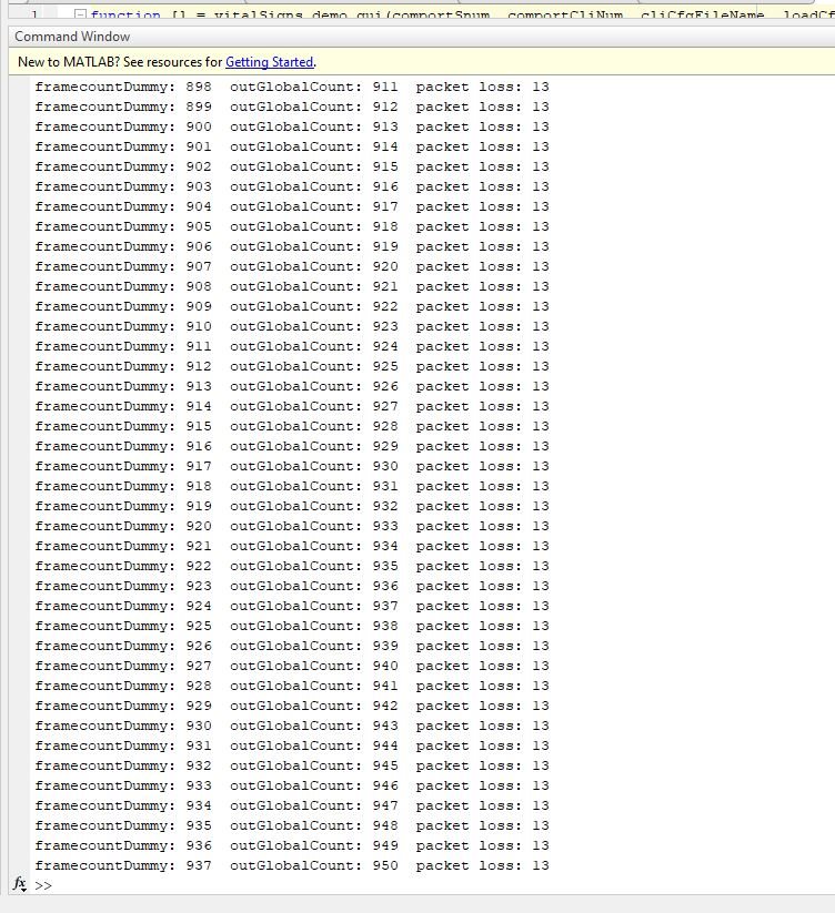

    I modified the GUI source code 'vitalSigns_demo_gui.m' and don't have zero columns of between each frame anymore.

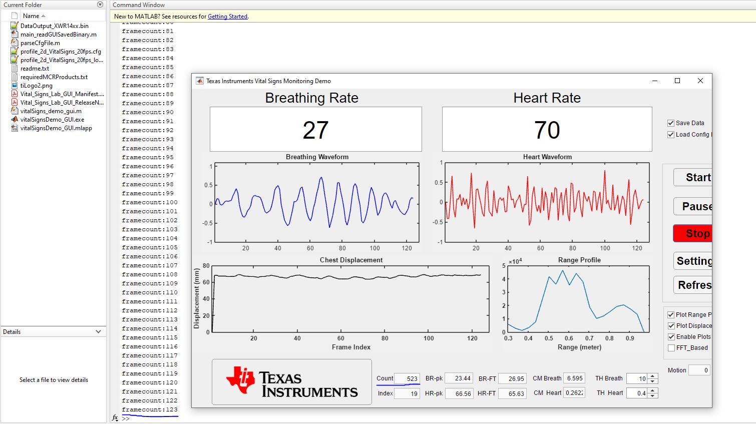

    However, I still have packet loss issue. I found that when I enable plot function of GUI, there will be packet loss.
    If I disable the plotting function, there's only packet loss when initializing. So the number of packet loss remains '13' for whole process.
    I think the plot function slowdown the CPU to get the new data packet from UART. Do you have any suggestions to solve this issue? Like setting priority of serial port or interrupt.
