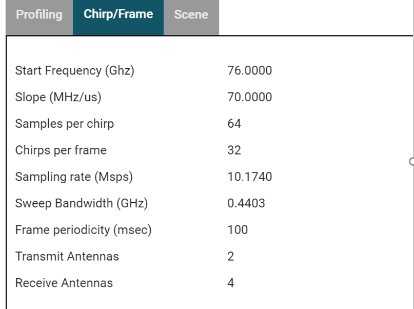

I am using AWR1843, and  mmWave Demo Visualizer. with the configuration  AWR1843 can work well and detect the target.
Now I want to know the pulse width and bandwidth of the signal that the sensor TX.
I find from the Visualizer, here are some parameters but not including pulse width and bandwidth. How can I know pulse width and bandwidth?  And what is the "Sweep Bandwith" mean?

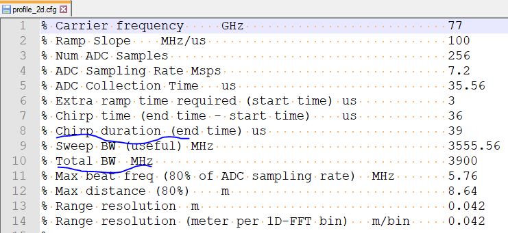

    I would request you to refer profile configuration provided in the mmw demo. It provides a high level of device configuration in the comment form.
    C:\ti\mmwave_sdk_03_03_00_03\packages\ti\demo\xwr18xx\mmw\profiles\*.cfg
    Sweep BW is the frequency bandwidth used to capture the ADC data during a single chirp/pulse.
    You can calculate these values from the CLI command parameters.
    chirp duration = profileCfg->rampEndTime + profileCfg->idleTime;
    Total Freq BW by a chirp = profileCfg->freqSlopeConst * profileCfg->freqSlopeConst MHz

    1) Sorry about that typo, correct calculation: Total Freq BW by a chirp = profileCfg->freqSlopeConst * profileCfg-> rampEndTime MHz
    2) Sensor has two VCOs to generate the frequency ramp, VCO1: 76-77Ghz and VCO2:77-81Ghz freq band. If you need to achieve more than 1GHz freq band then set start freq from 77GHz can go upto 81GHz.
    JG
  • Hi Jitendra,
    For question 2), I need to use VCO1: 76-77Ghz. Maybe my description is not very clear. I mean, for example, I want "Total BW" 400MHz, or 200MHz, Can these BW be realized by setting some parameters?
    Thanks.
    As I metioned in answer 1, total BW is mainly depends on freqSlope and rampEndTime of chirp which sweep the frequency ramp.
    So to achieve 400/200MHz you need to play with these two parameters of profileCfg CLI command.
