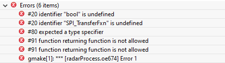

I am trying to use SPI to communicate to the launch pad that I have, but I can't even get started because whenever i add this line to the radarProcess.c file in the DSS project:
#include <ti/drivers/spi/spi.h>
I get these errors:

Hi Sam,
You can access SPI from only Master Sub-system(MSS).
Yogesh
