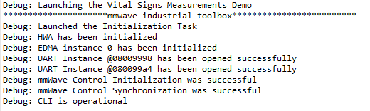

    Doing people count iwr16xx, I cant able to get the console. After Debug , we used to get that commands like CLI is operational.. The below command is not coming for both dss and mss..
mmWave industrial Toolbox - 4.1.0
mmWave SDK -2.1.0.04
After giving the Run process, it is still in build finished command only..
Anyone please help me out to resolve this issue..

  • Hi ,
    I got to resolve this issue..
    My mistake is in Debug process, I was loading the prebuild XER4F(MSS) & XE674 (DSS) BIN files. I was followed the Quickstart UserGuide so the path which they have given  C:\ti\mmwave_sdk_version\packages\ti\utils\ccsdebug. Due to this it haven't shown any logs or commands in console.
    So, I just loaded my XER4F & XE674 BIN files in my workspace path. My console works properly..
    Thanks for your kind support.
