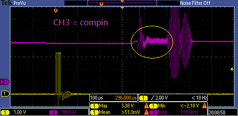

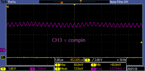

And I have a problem is that the strange oscillation about 3.3MHz in after RX rising till whole echo listening
Although there is only figures had seen from compin pin,but it had appeared in LNAOUT , and it amplitude is about ten times bigger than PGAOUT (a one-step bandpass filter between PGAOUT&COMPIN)
  • Hello User,
    Thanks for posting your question. The LNAOUT is the output of the first stage RX path. I would probe the input of the RX to confirm if there are any oscillation at the input. If the inputs are oscillating it most likely that the the LNAOUT is amplifying the input. If the inputs are noisy due to the grounding or disturbance due to the transducer. I recommend that you follow section 8.3.3 that describes the capacitance selection for providing the stability of the amplifier.

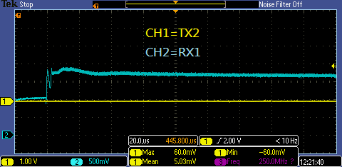

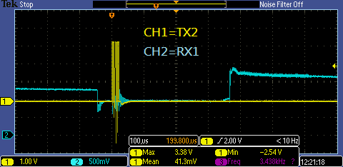

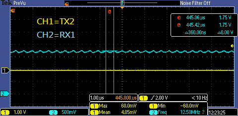

  • Hi , Prakash   thanks you for replying my question
    The RX exactly have the same noise(I disconnected all the trace before RX pin and derectly probe RX pin) , and I will try 8.3.3 that you suggested lately.
