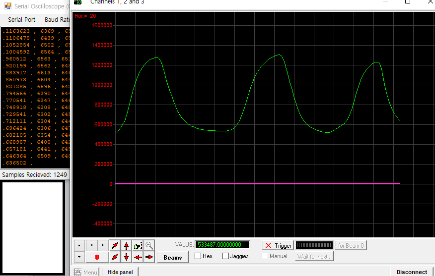

    With that code above, I confirmed that digitized value is increasing when the sensor is stretched (regardless of its sign).
    I also confirmed that the capacitance value of my stretchable sensor is increasing when it is stretched (via LCR meter).
    Always thank you for kind answering.

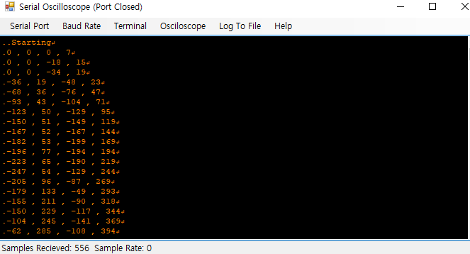

    +Addition) Here is negative valued data.
    It appears randomly.
  • Hello DongWoo,
    Thank you for sharing the additional information. Can you clarify how you are getting the data above? Those numbers are very small and are not expected output values for the FDC2214. Are you calculating the sensor capacitance from the raw output data?
  • Oh, I forgot stretching sensor during observing. That was the value at the beginning of connection to the computer.
    Here is new information.
    Increase of curve means stretching is occurred and increase of capacitance.
    As your opinion, I want to try calculate the capacitance value from my sensor.
    But with this pattern, I`m not sure I can calculate original capacitance value from this data.
    (As my expectation and your opinion, it should be decreased when sensor is stretched.)
    Always thank you for your advice.
  • Hello DongWoo,
    Do you have an FDC2214EVM available? Can you try connecting your sensor to the EVM and monitoring the sensor frequency with the GUI? I'd like to see if the frequency increasing behavior still occurs with known hardware and software.
