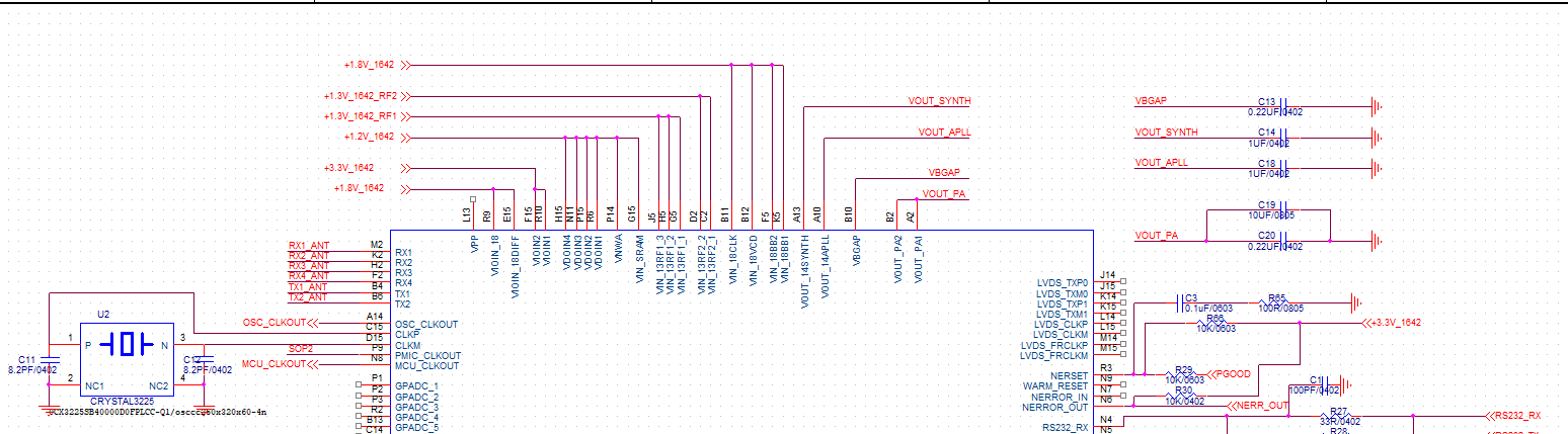

Boot mode:101(SOP2~SOP0) AWR1642 Can be downloaded normally.
Boot mode:001(SOP2~SOP0) AWR1642 Unable to boot .
We have tested RESET and POWER rail to meet timing requirements.
SOP2~SOP0 Signal is ready when released RESET.
All supply voltages are normal
VOUT_14SYNTH output is 0V.
Is there any reason why AWR1642 cannot start normally?
