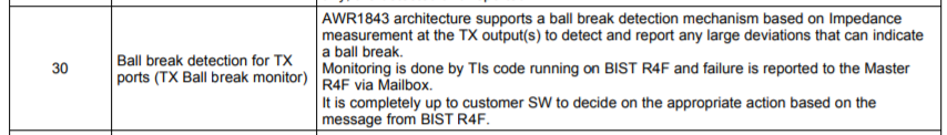

  • Hello Kisub,
         Typically Tx ball break monitoring is used in the safety critical applications, This provides rough TX reflection coefficient’s magnitude values, meant for detecting TX ball break, in case of any adverse scenarios in the application, From this information safety host could take appropriate actions in the safety critical system.
    Currently this API is not available in the device firmware; as it's not yet developed in the firmware.  In the future it is being planned (Approximately 2nd half of next year).

  • Hello Kisub,
         For the ball break monitoring APIs are defined in IWR6843, However when APIs are issued underlying firmware present in the BIST processor would measure and reports the values. Currently for the IWR6843 this firmware yet to be developed.
    If you really want to use this feature, you may want to explore Automotive family of devices AWR1642/AWR1843 devices which supports this feature as part of monitoring APIs.
    Thanks and regards,
    CHETHAN KUMAR Y.B.

  • We have AWR1843.
    We succeeded in measuring the reflection coefficient using mmwavelink and AWR1843boost.
    RL_RF_AE_MON_TX0_BALLBREAK_REPORT [0x1]
    RL_RF_AE_MON_TX1_BALLBREAK_REPORT [0x1]
    RL_RF_AE_MON_TX2_BALLBREAK_REPORT [0x1]
    ReflCoefVal: tx0 = 0xffffff98 tx1 = 0xffffff83 tx2 = 0xffffffffff88.
    However, the mmwavelink only runs one test.
    We want to know how to measure the reflection coefficient value continuously.
