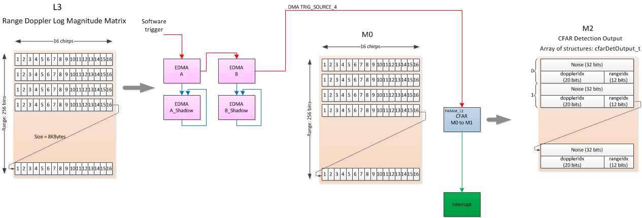

  • Hi Alan,
    Would you be able to post a code snippet of how you are trying to implement this?
    As shown above the CFAR computation is performed in M0 and is output into M2 with a CFAR completion interrupt. This is described in the mmWave Doxygen, this specific page is at: C:/ti/mmwave_sdk_02_01_00_04/packages/ti/demo/xwr14xx/mmw/docs/doxygen/html/index.html#dataCFAR
    Cheers,
    Akash

  • Hi Alan,
    An explanation for setting the peakGroupingCfg.inDopplerDirectionEn variable might be that the High Accuracy Lab does no Doppler processing, only Range Processing. Is there an implication to not setting this variable? You had mentioned that the sensor chirps and reports distances. This variable is only set in the Out Of Box (mmw_cli.c, 223) and Vital Signs Lab (cli.c, 336)  for the IWR1443 demos.
    To the second question, the CFAR will need to be reconfigured since Range and Doppler are stored in the L3 together (see my diagram above). If you'd like to discuss this further then I would like to get another expert involved. Would you be able to open up a new thread with part number IWR1443 with context around the Out-Of-Box demo, not 4K or High Accuracy Labs.
    Also it appears the TODO comments were left in the code unintentionally, thank you for pointing this out.
