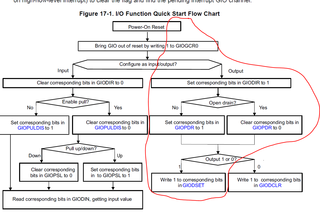

Hello All,
For the target AWR1843, I just want to use the GPIO module of the core (cortex R4F) and set a pin as an output and produce a high voltage on it. I followed what is written in the technical manual but it didn't work.
I have attached a snapshot from the manual to set a pin high. It is urgent. Thanks in advance.
