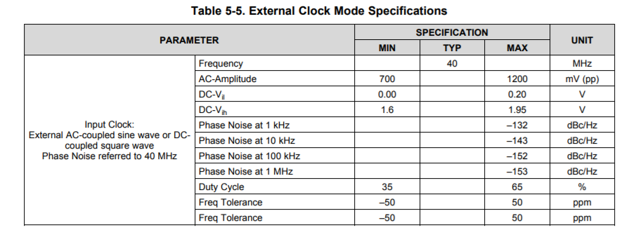

I have IWR6843ISK-ODS (antenna module), mmWaveICBoost, and DCA1000EVM.
I want to synchronize the antenna module with an external reference oscillator to synchronize the frequency and phase with another devices' them.
The sensor chip IWR6843 supports external oscillator and externally driven clock at 40 MHz, however, IWR6843ISK-ODS is already connected to a crystal on the board.
The board has a OSC_CLK_OUT pin, but no IN.  It has SYNC_IN pin but it should be used for synchronizing the start timing of chirp radiation, not for the frequency reference, I guess.
Is there any method to synchronize the antenna module's frequency with an external reference oscillator? e.g., reference oscillator input pin (maybe connect to ball number B15 CLK_P of IWR6843) or controlling PLL with the external synchronization pulse.  Or, if I re-solder the antenna module's port of the crystal, the board can operates with an external oscillator?
