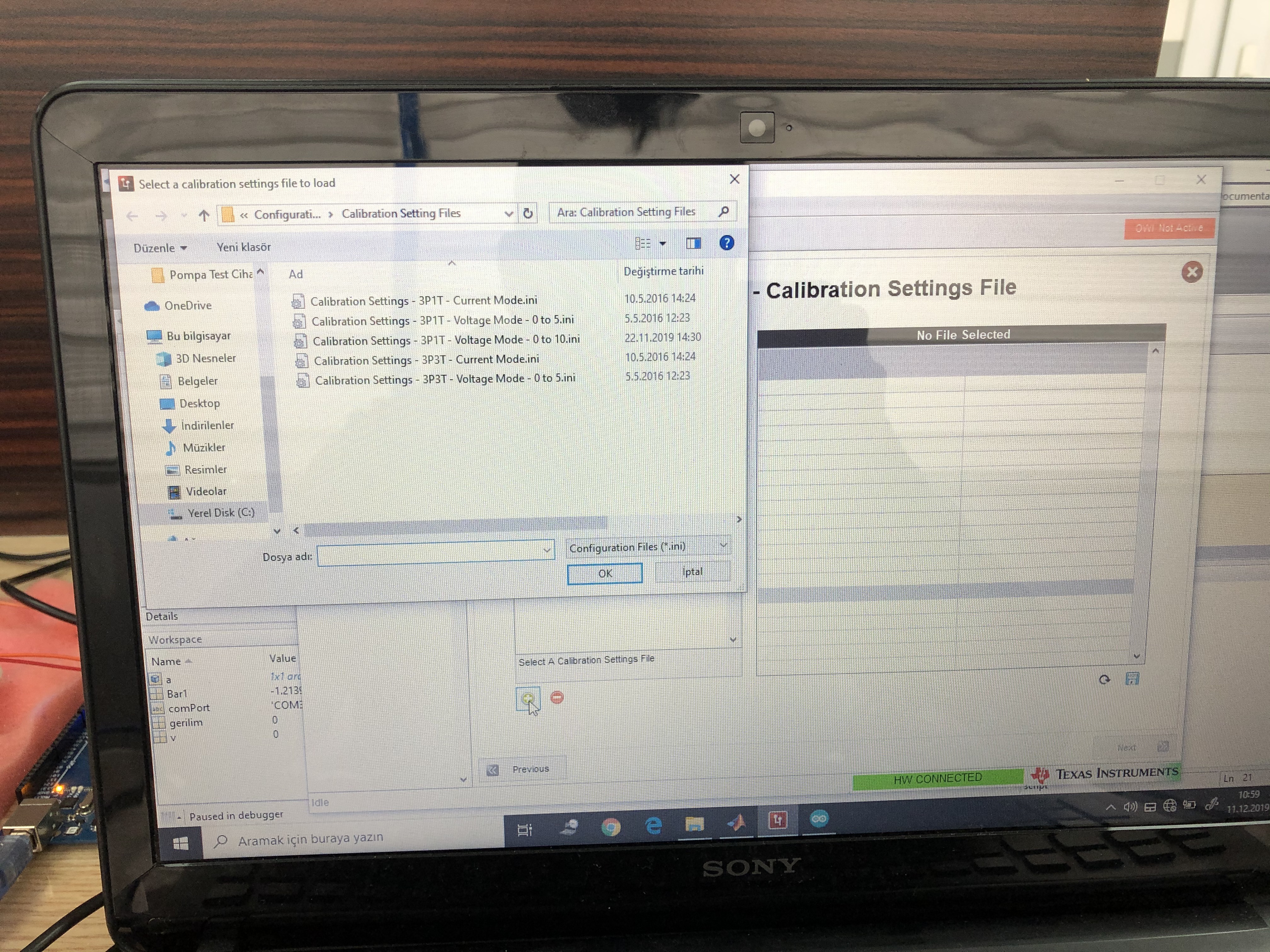

I want to use "Guided Calibration" in the PGA300 GUI. But I have got a problem. Calibration file isn't visible (picture-1)

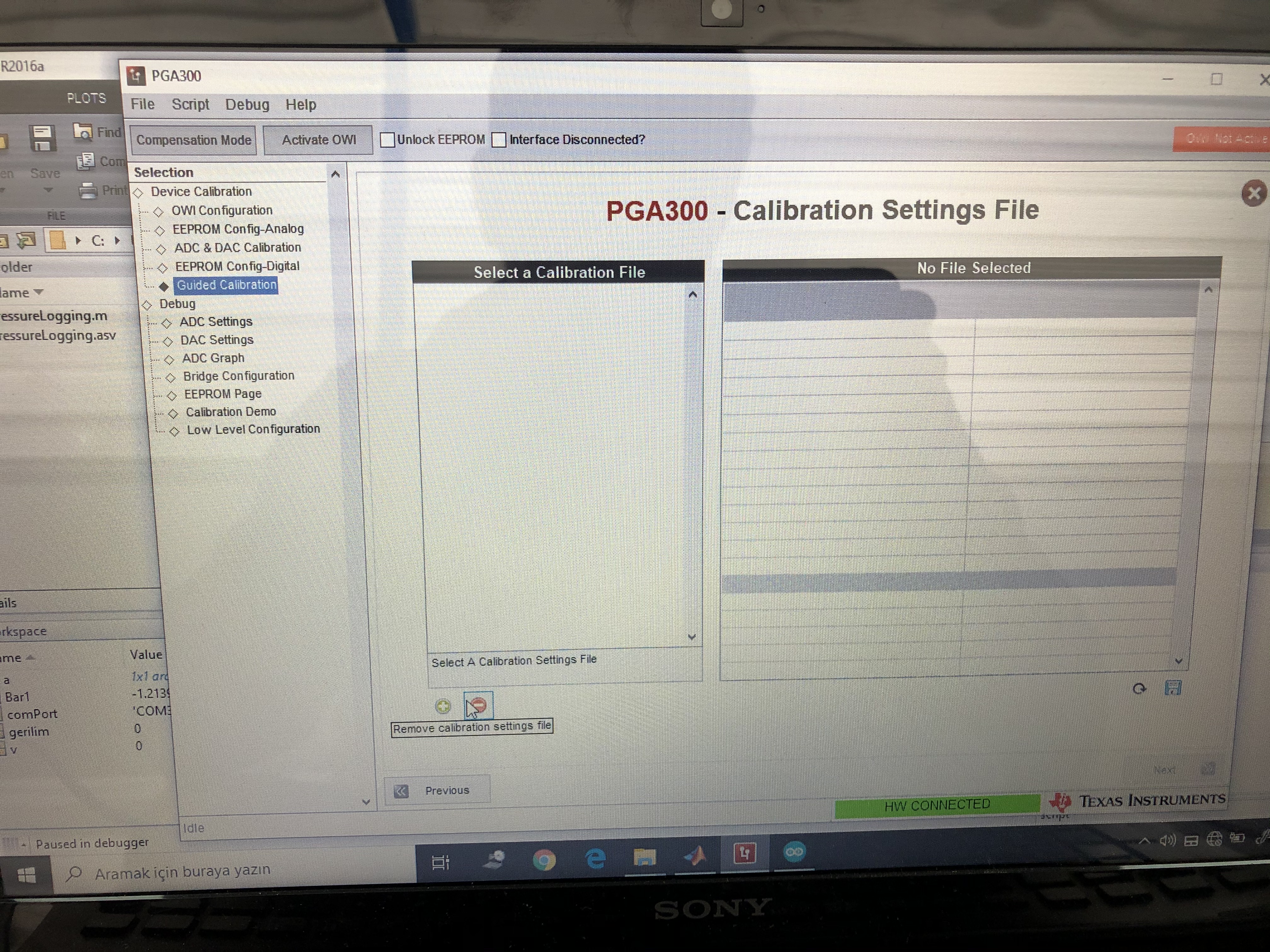

Then I'm adding calibration file. (picture-2)

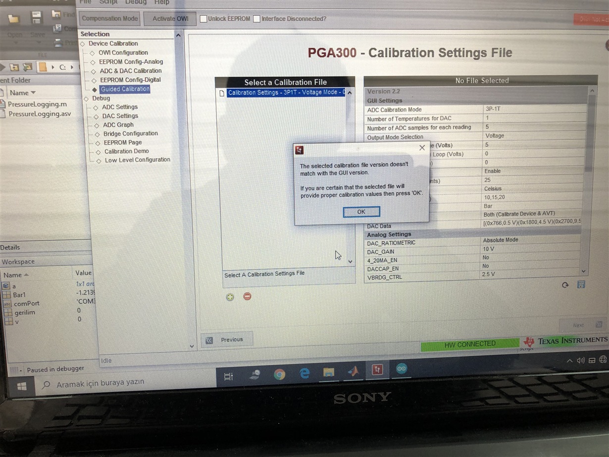

But I'm taking a error. The error is in the below. (picture-3)
The problem is obvious."The selected calibration file version doesn't match with the GUI version."  But how I solve this problem?
Thank you very much..
  • Hello Ibrahim,
    Can you please check the GUI version by going to the Help menu and selecting "About"?
    After you try to load one of the included setting files it will fail as you've shown in your image above, but once you click OK on the error message, does the right-side frame continue to display the configuration options? Or does it go back to a blank white frame like in your first image? If the configuration options are still available are you able to adjust them and save the file like normal? If you can, I suggest trying that and then reloading the configuration file you just saved. That file should be compatible with the GUI version you are using.
