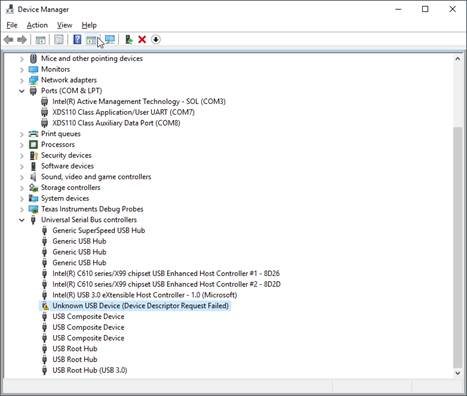

We're trying to use the AWR1642 and DCA1000EVM together to capture raw radar data.
After installing all the necessary software (i.e. mmWave Studio, Code Composer, Matlab), plugging the micro USB cables to ports J1 and J8 and energizing the circuits, in the device manager from the PC, just the two COM ports from the AWR1642 show up, but not the ones from the DCA1000EVM (as you can see on the first image attached below).
I´m aware that the USB device seems to have an issue (since it says “Device Descriptor Request Failed”). However, after doing some research and reading forums from TI, the solution provided seems to be installing FTDI drivers. The installation worked fine, but still the USB port reports the same issue.
We would like to know if this is a reported problem and, if so, know the solution on how to address it (or how to work our ways around it).
