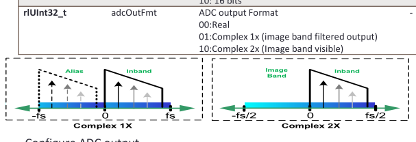

Hi,team:
What's the difference between complex 1x and complex 2x in ADC output format?
I think Complex 1x has inband signal and alias signal, complex 2x just has inband signal , right?

Sorry for late reply
In complex1x output mode a decimate by 2 is performed using frequency centering, decimation and de-centering processing blocks
In complex2x output mode these blocks are bypassed and complex baseband output is produced at 2x the optimal rate. In-band and image band are visible in final output.
