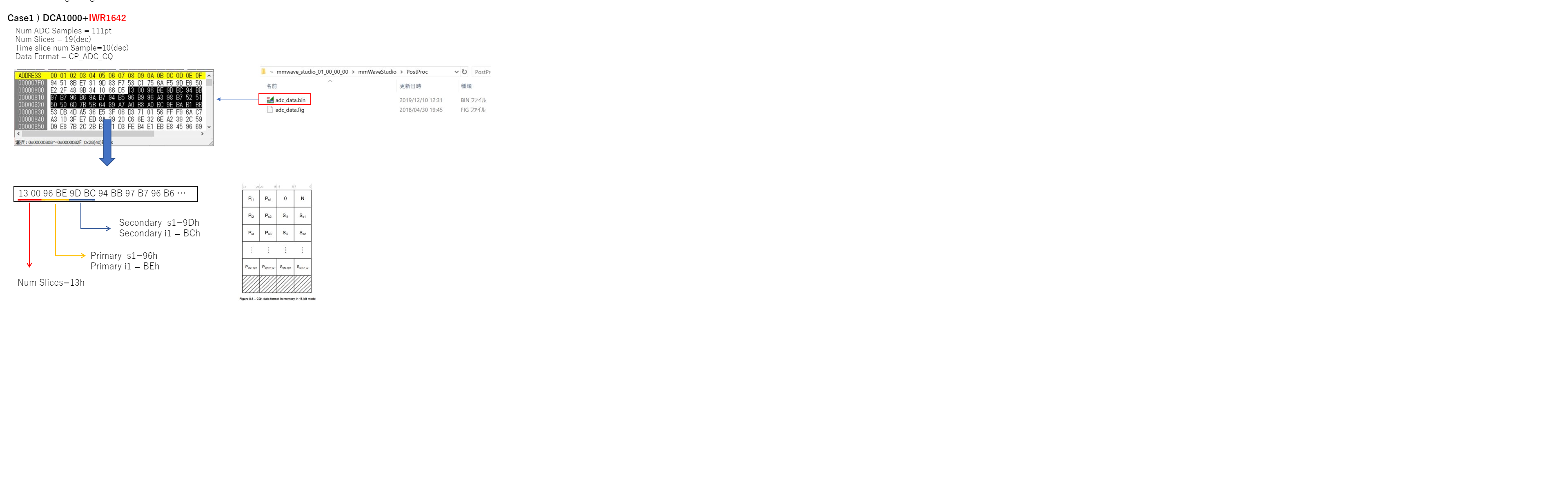

(case1)
The conditions are described below.
DCA1000+IWR1642
Num ADC Samples = 111pt
Num Slices = 19(dec)
Time slice num Sample=10(dec)
Data Format = CP_ADC_CQ

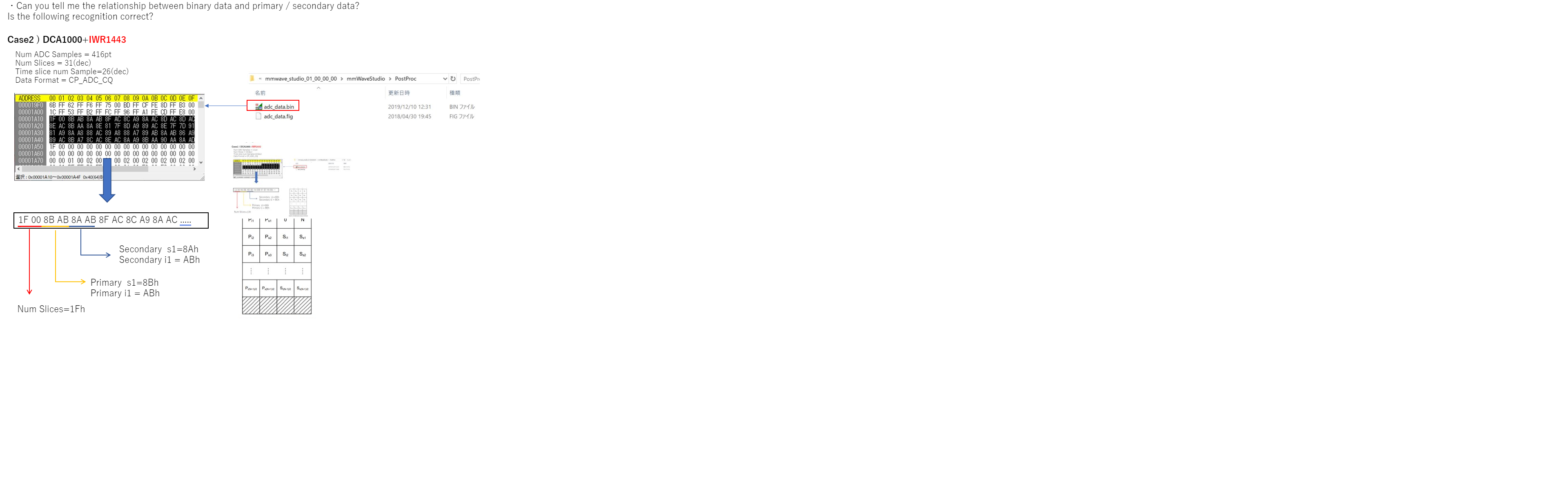

(case2)
DCA1000+IWR1443
Num ADC Samples = 416pt
Num Slices = 31(dec)
Time slice num Sample=26(dec)

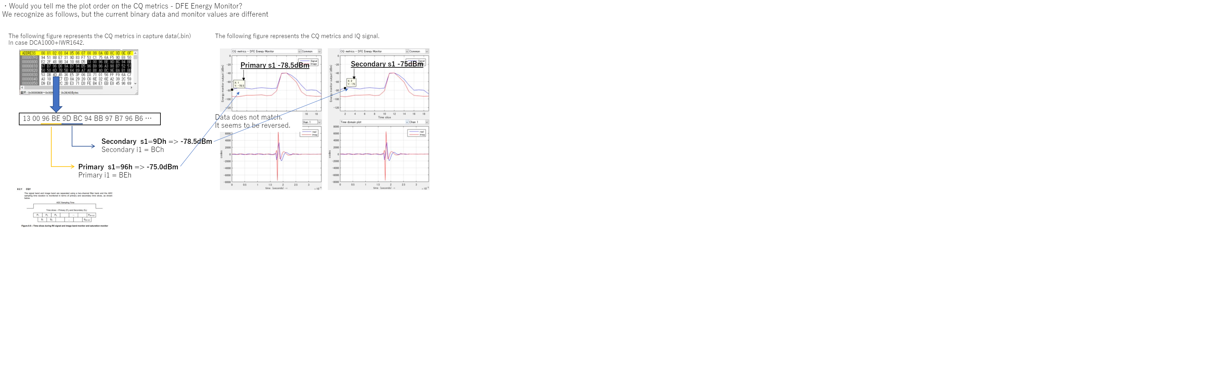

・Would you tell me the plot order on the CQ metrics - DFE Energy Monitor?
We recognize as follows, but the current binary data and monitor values are different
  • Attach the drawing because it could not be attached.

  • Is my following understanding right?
    You have found the document about the CQ data format in DSP, and it matches well with the memory content.   But when you look at mmwave radar Studio output (the post processing curve), it does not match well, right?   You want to understand why they are not matching, right?
    I am confused, how can you look at the memory in DSP and looked at the results in radar studio at the same time?
    Zigang
  • hi,ZIgang
    thank you for your reply.
    Sorry at the lack of explanation.
    The content I want to hear is exactly what is said.
    I thought that the reason why the CQ data and the CQ metric curve did not match was because I did not understand the data format correctly. I was asking for the data format for that.
    Also, although I could not answer in the previous question, I am currently acquiring the CQ data of adc_data.bin with the configuration of IWR1443 + DCA1000. However, for the CQ metric curve, I use a tool that I created based on the data obtained.
    Regarding DSP, my view is that the data format differs between the IWR1443 + DCA1000 configuration and the IWR1443 + DSP configuration. Therefore, I would like to tell you if the data format configuration differs between the above two configurations, and asked a question.
    keisuke tanaka

  • HI,
    You are right.  The data format in the linked document is only valid for the data access through CCS.
    For the radar studio, the data will format in the following way:
    CP_data
    -          4 bytes (ADC_CP or CP_ADC or CP_ADC_CQ mode).
    -          0 bytes (ADC mode)
    CQ_data
    -          0 bytes (ADC, ADC_CP or CP_ADC).
    -          Ceil((cq_val * 16 / numAdcBits)) bytes (CP_ADC_CQ mode)
    Where cq_val = CQ0TransSize + CQ1TransSize + CQ2TransSize (given in Data path configuration), numAdcBits = 12/14/16
    One chirp data should be with following order:
    1)      Two 16-bit CP for RX0
    2)      Then a chirp of ADC sample of IQ data for RX0
    3)      Then two 16-bit CP for RX1
    4)      Then a chirp of ADC sample of IQ data for RX1
    5)      Then two 16-bits CP for RX2
    6)      Then a chirp of ADC sample of IQ data for RX2
    7)      Then two 16-bit CP for RX3
    8)      Then a chirp of ADC sample of IQ data for RX3
    9)      Then followed with CQ data.
    Let me know whether it makes sense
    Zigang
  • HI,Zigang
    Thank you for your response. It was helpful.
    But,I want to know the details of (9.Then followed with CQ data).
    I recognize the following flow, is that OK?
    1) Num Slices: 1byte
    2) 0: 1 byte
    3) Ps1: 1 byte
    4) Pi1: 1 byte
    5) Ss1: 1 byte
    6) Si1: 1byte
    7) Ps2: 1byte
    8) Pi2: 1byte
    5) Ss2: 1byte
    6) Si2: 1byte
    Keisuke Tanaka
  • HI,
    It is little bit tricky.  I believe when the data saved in DSP, it is in the format.   But when it read back through LVDS, it can be tricky.  For example, the complex ADC data for IWR1642 in DSP is saved in the order of
    I0, Q0, I1, Q1, I2, Q2, I3, Q3, and etc
    However, when writing to LVDS,
    LVDS lane 1 takes: I0, I1, I2, I3
    LVDS lane 2: takes Q0, Q1, Q2, Q3
    At the output of radar studio, the binary data format is:
    I0, I1, Q0, Q1, I2, I3, Q2, Q3.
    So it is different between these two order.   I am not sure for CP_ADC_CQ data, is it following the same order change.   I notice that CP and ADC is following the same change. But I am not sure about CQ yet.
    Zigang
  • Can you check if you reorder the CQ data the same way, whether it explains the CQ plot you have seen before.
    Zigang
