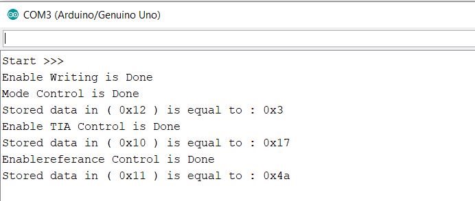

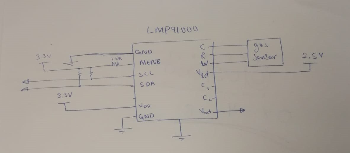

      Can you send me a schematic and an outline of the setting you made, so I can review your setup to see what might be the problem?
  • Mode Control Register (Address 0x12) : ( 00000011 ) : ( 0x03)
    Status Register (Address 0x00)
    Protection Register (Address 0x01)
    TIA Control Register (Address 0x10) : ( 00010111 ) : ( 0x17 )
    Reference Control Register (Address 0x11) : ( 01001010 ) : ( 0x4A )

        the MENB pin is pulled high and left high. (MENB  Module Enable, Active-Low) Look at the timing chart below. You have to pull this pin low or it will not respond to I2C.
  • We pulled MENB low, still not change in Vout pin (no response)

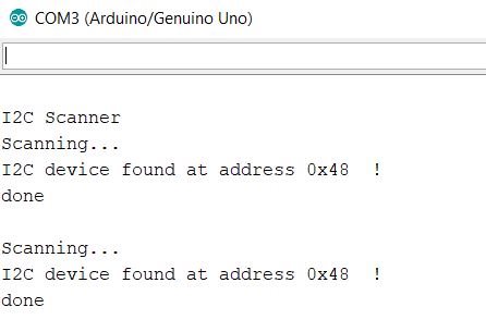

      What are the pull up resistor values you are using for the I2C pins?
    Have you looked at the I2C pins to verify that the data waveforms looks good?
    Have you hooked up a protocol analyzer (or I2C shark) to verify that the data is good going into the LMP91000?
    Please send scope shots of the communications if possible.

    We have to contact where we read the main address and read all values in the registers. But there is not change and no reading from gas sensor.

  • Read back the Status register. What value are you getting? If you are not getting a 0x01 then the LMP91000 is not ready to accept I2C writes. You should be reading this register before trying to write the others.
    Also make sure the Lock register is set to 0x00 to write the other registers. A 0x01 will put it in read only mode.

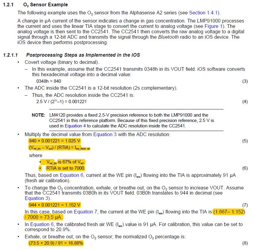

  • Dear user6246305 -
    You may want to consider changing the setting for 0x10 through 0x12 registers.
    I examined the settings using the 02-A2 sensor from Alphasense, mounted on the LMP91000 EVM, using 0x03 for 0x12, 0xC0 or 0xC1 for 0x11 and 0x0E for 0x10, this allowed a correct current level from the sensor and corresponding O2 and voltage levels from the GUI.
