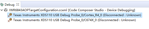

I'm using IWR6843AOPEVM + MMWAVEBoost. I have flashed  oob demo(imported to CCS and build) into board and it works well. Now i want to debug the demo(mmwave_sdk_68xx_aop_hwa) and have flashed the xwr68xx_ccsdebug.bin(located in mmwave_sdk_03_02_00_06_AOP\packages\ti\utils\ccsdebug). After the configuration of ccxml, xds110 shows disconnected as picture below. Do i miss any steps? Is there any more specific instruction? Looking forward for your support! Thanks!!
