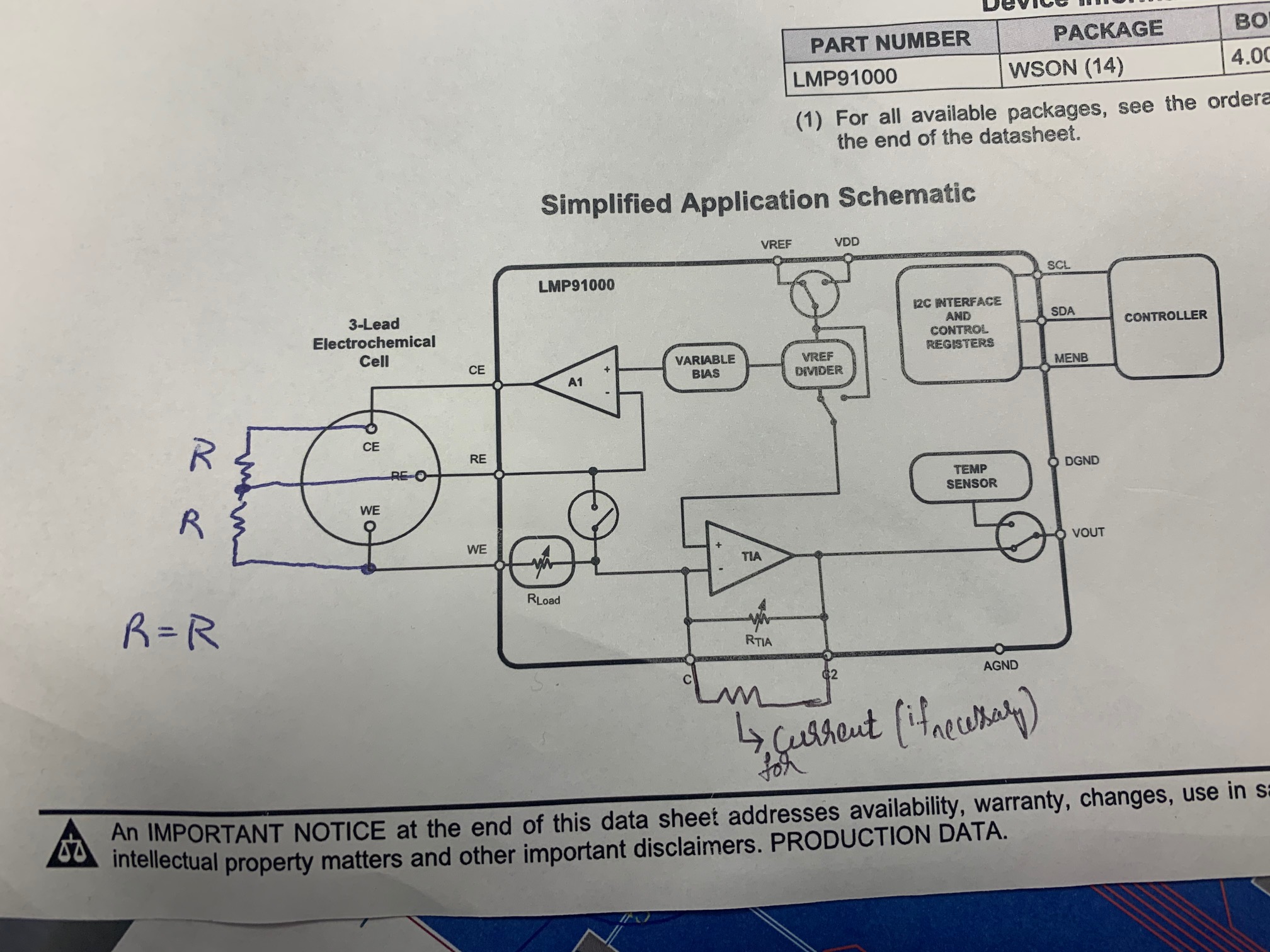

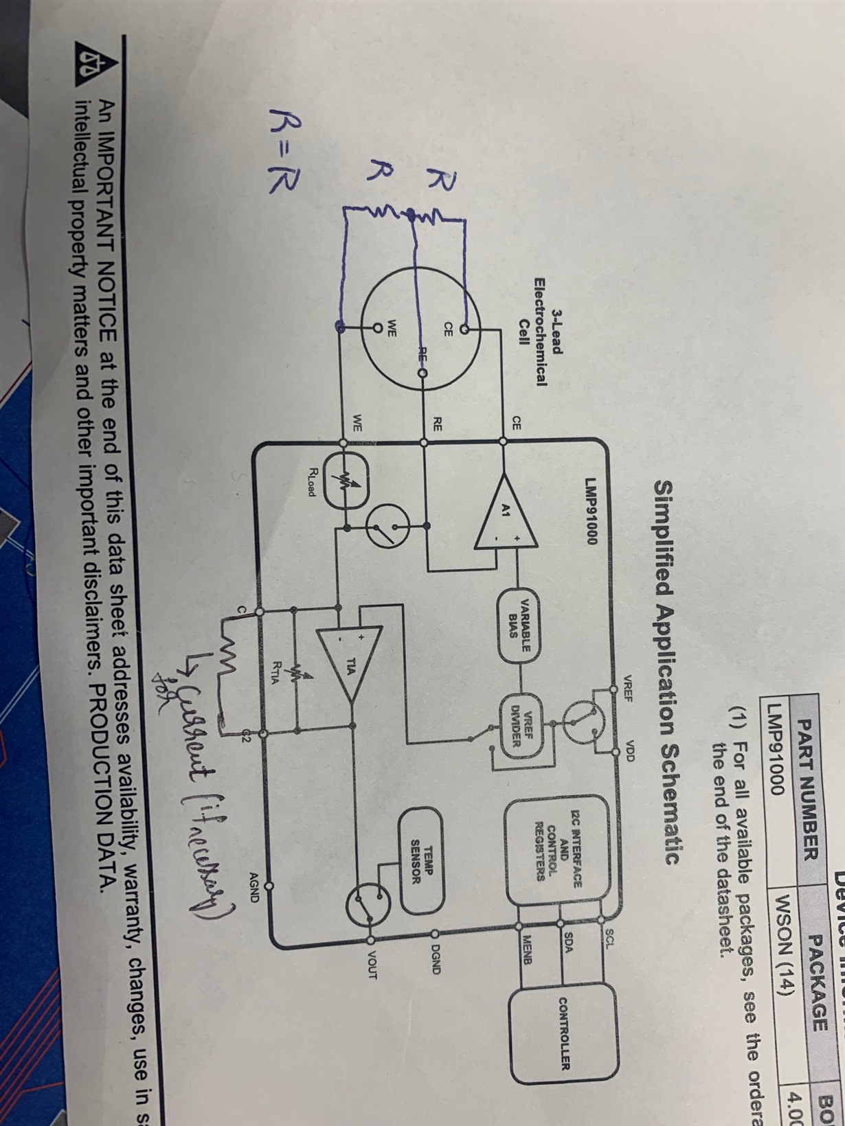

I am new to LMP91000 boards, I am trying to communicate with LMP91000 using PIC32MM0064GPL036. I am using I2C bit bang code, since this PIC doesn't have hardware modules. I do not have any sensor connected to LMP91000 eval board. I am just trying to change the bias value and check the Vout for different bias value. Even when I change the bias, the voltage at all electrodes and Vout is not changing [CE, RE: 1.57,, WE: 1.1, Vout: 2.88]. I am not sure if there is an issue with the code or LMP91000. I am simply using resistor network between CE, RE, WE. I am attaching a picture of the resistor network. Here's some lines of my code:

  • Hi Josh,
    Thank you for the response. I think the code is correct and the jumpers are also correct. I am writing to bias registers and then reading them from registers. The values are changing, my question is does the LMP91000 work correctly with just resistor network? I am using 10K resistors. The voltages I am seeing now at CE, RE, WE are 2.49 and Vout is 2.48 when bias ref is 0%. I am using internal reference and when I change the bias to 24%, the voltages at CE, RE and WE is 2.37 and Vout is same as well. Is that what is expected? I am new to this device and I am still trying to understand the working.
  • I would recommend getting a sensor and following test procedure found on page 26 of the datasheet.
