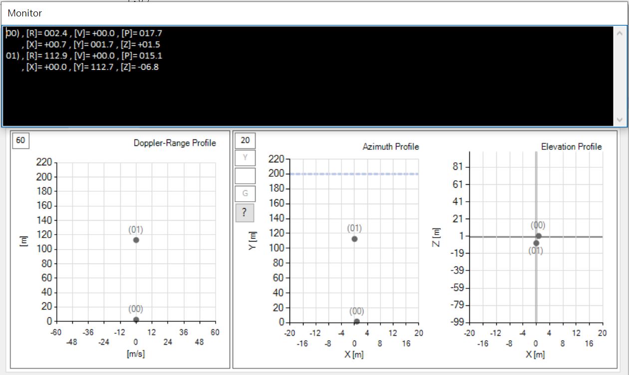

There is a phenomenon, I do not know if it is correct ?
The z-xis(elevation) is zero when using 1T4R(Tx1) config.
The z-xis(elevation) is zero when using 1T4R(Tx3) config.
The z-xis(elevation) is NOT zero when using 1T4R(Tx2) config.
How can I deal with this phenomenon ?
Can I ignore the value of the Z axis for 1T4R(Tx2) config?
Thanks.

  • Hi Kris Lin,
    The phenomenon is due to the fact that the TX antenna is in the elevation plane. Please look at the TX2 antenna on the AWR1843BOOST , it is slightly offset from the other 2 TX antenna in the elevation direction.
    You will need to make below configuration to not using TX2.
    channelCfg 15 5 0
    chirpCfg 0 0 0 0 0 0 0 5
