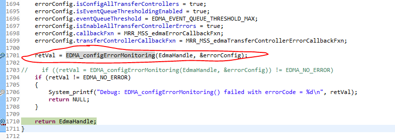

The return value here is -3109. Customer would like to know what's the problem?
Annie
  • Hi Annie,
    The error value what you mentioned here corresponds to MMWAVE_ECHIRPCFG (based on SDK 3.2)
    Could you step in this function while debugging from CCS and find out exact line which is setting this error. You may need to map to edma library source code in the CCS window for that.
