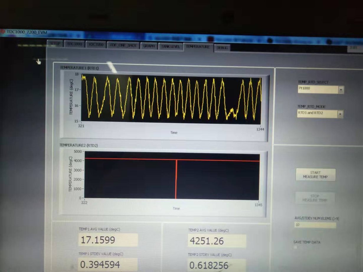

The only support available for this issue is what is listed in the TDC1000 FAQ (https://e2e.ti.com/support/sensors/f/1023/t/724028?TDC1000-Everything-You-Need-to-Know-for-Ultrasonic-ToF-Liquid-Coupled-Collateral-Tools-Designs-FAQ-):
Why are my temperature readings incorrect on the GUI?
This situation is caused by erroneous short pulses generated when measuring the resistance of the RTD. The mechanism and workaround for this behavior is described in the following application note:
Measuring an RTD Sensor with the TDC1000 and TDC7200 for Ultrasonic Sensing: www.ti.com/.../snaa230.pdf
When measuring the temperature value with the TDC1000-TDC7200 GUI ensure that the TEMP_MODE on the TDC1000 page is set to "REF_RTD1_RTD2", and that TEMP_RTD_MODE on the TEMPERATURE page is set to "RTD1 and RTD2" regardless of whether one or two RTDs are being measured at that time. The GUI automatically implements the workaround to provide the correct reading for RTD1.

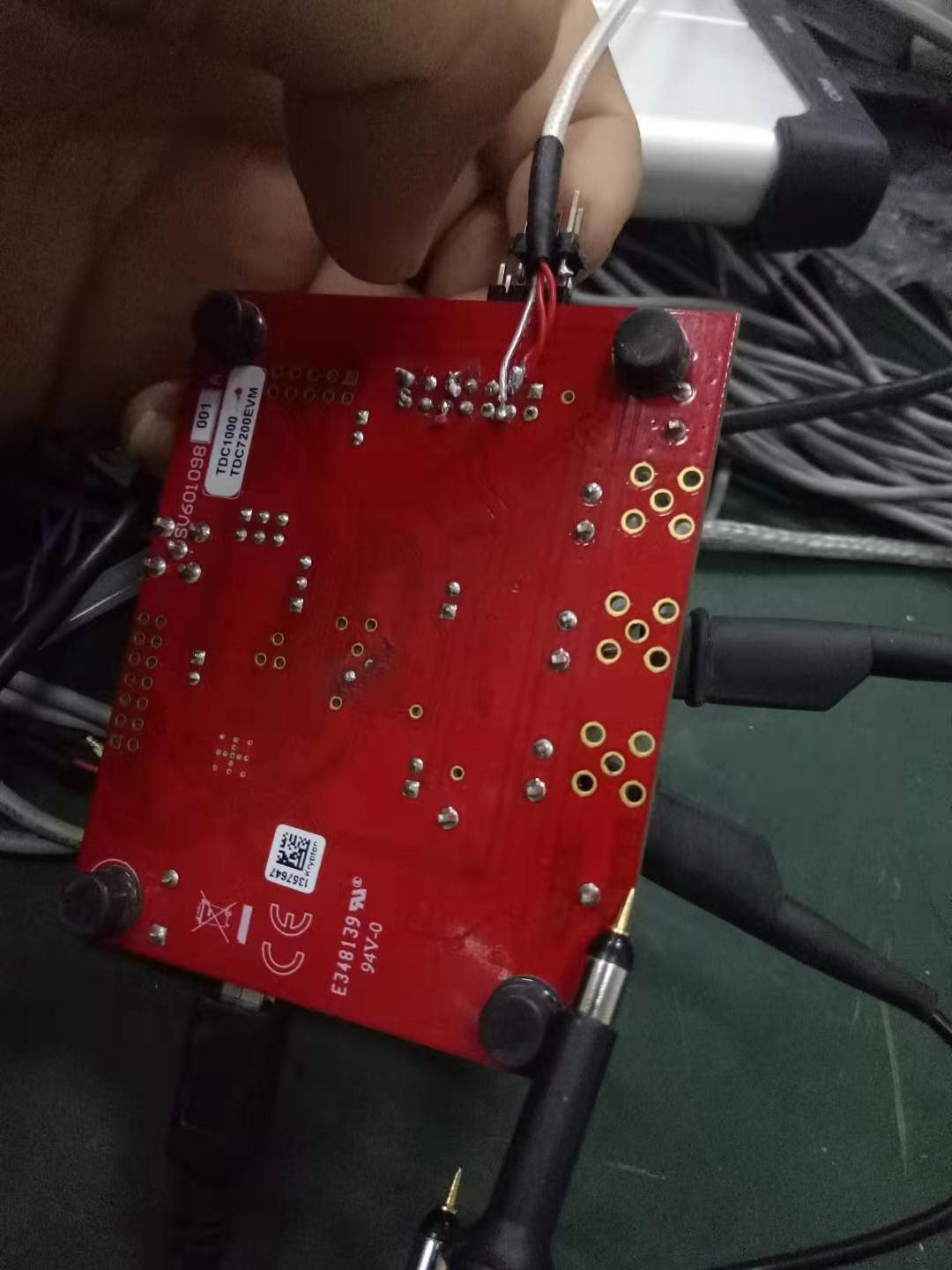

user3697981,
I have only seen two-wire PT1000 and PT500 RTD types used with the TDC1000. Please see these other E2E discussions to help troubleshoot your temperature measurement error:
