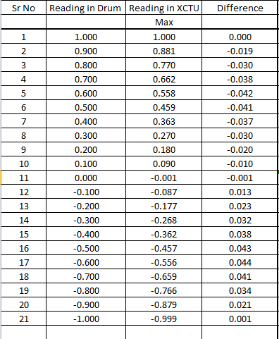

  • Dear Scott,
    Above issue has been solved.
    Attached below are the displacement we are getting at the
    We have calibrated at 1.000 , 0.000 and -1.000.
    here we have used LVDT probe drump for calibration and X-CTU for software reading.
    the behavior we are getting is non-linearity if this behavior we are getting below as per below reading then we are used for further development.
    If there is any solution then please let us know.
    Kindly reply it on urgent basis.
  • Hello Vai,
    What are the accuracy targets? It looks like it's behaving as I would expect it to with the largest deviations being at the points that are furthest away from the calibration points, and the best accuracy at the calibration points. But it depends on what your accuracy targets are if that is acceptable.

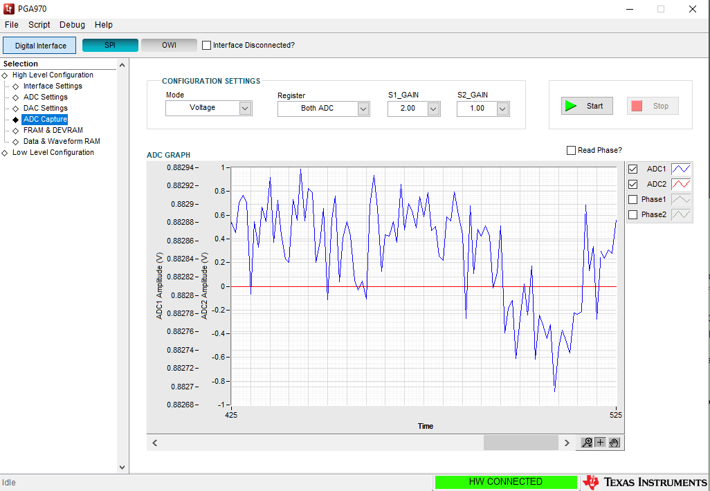

  • Dear Scott,
    Mention below is  the setting done in evaluation board,
    While reading from ADC the variation is shown in below image.
    Also i have attached the Excitation waveform video and secondary excitation video,
    Their is slight variation in both primary and secondary waveform.
    I am getting variation in read ADC also the supply is Fixed Voltage.
    Kindly Guide to solve the issue in ADC reading.
    Awaiting for your reply,
    VAI

  • Hello Vai,
    Thanks for the additional information. I'm going to be in the lab tomorrow to take a look at this to see if I can observe the drift on my EVM setup, and I will get back to you once that is done.

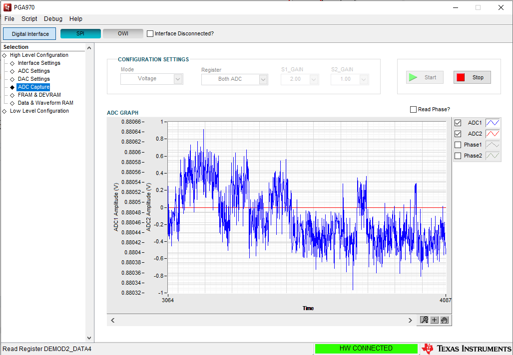

  • Hello Vai,
    Can you please show the ADC capture with the register set to "Both ADC" over a period of time with a fixed position to show how the ADC counts drift?
    Also, have you tried any different supply voltages? Do you still see the drift with a higher VDD? I would try 5V and 12V. This should not affect the drift, but it is another variable to test.
  • Hi Scott,
    Mention below is the image file as per your requirement.

  • Hello Vai,
    Sorry for the miscommunication. I would like to see a larger time period. Currently your graph window is set to scroll which only shows a short period of time where the drift is not apparent. Can you run the graph for several minutes, and then click on the magnifying glass in the bottom right corner and select the bottom left option. This will show the entire set of data in a single plot and the drift should be easier to see.
  • Hello Scott,
    Kindly give the solution for stable sine wave without any drift.
