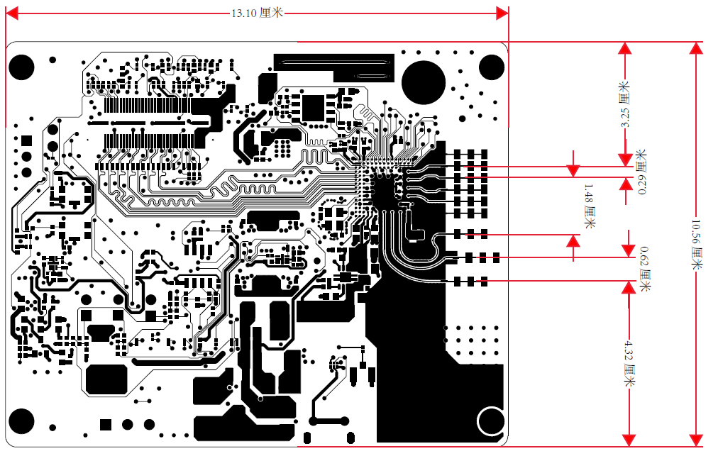

Like follow picture, I wonder the distance between the TX1 and TX2 in the vertical direction. Maybe you can tell me where the reference center of the antenna is.

The spacing between TX1 and TX2 in the vertical dimension is λ/2.
