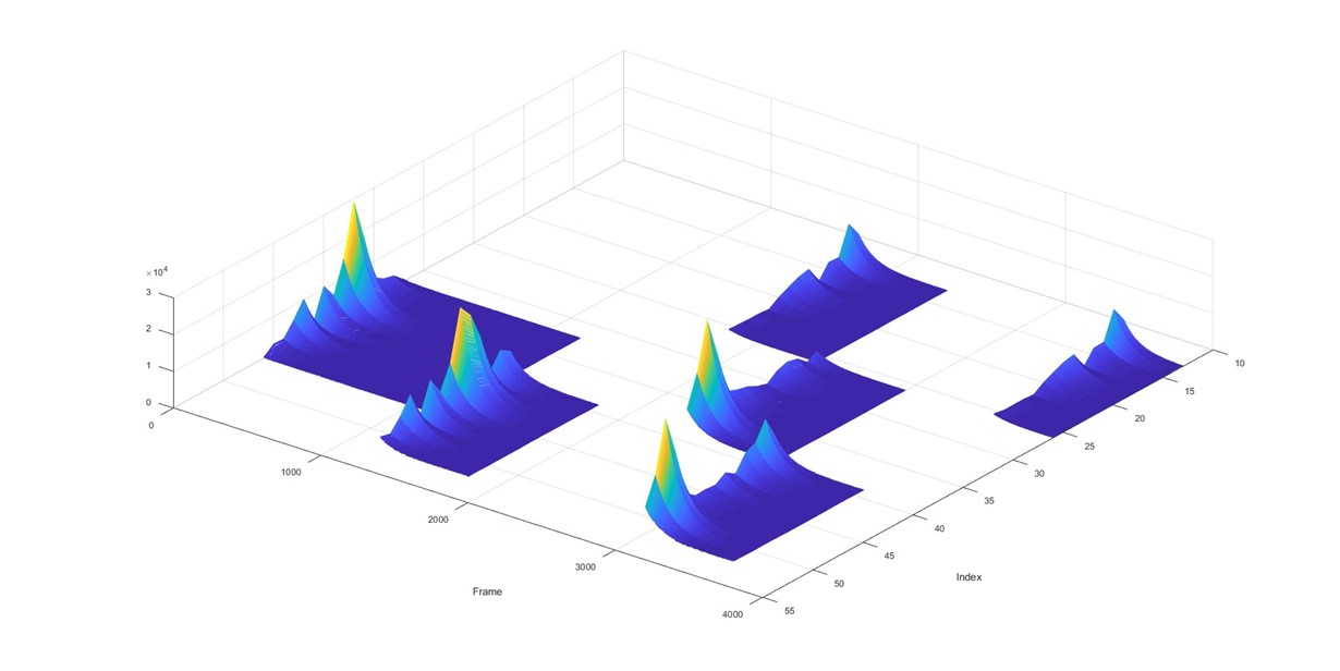

But in my case,  I changed the startIndex and endIndex during the measurement, so that the different ranges of range profile was obtained.
Surprisingly,  I always get a very large value every time when I get a new range profile.
In this picture, I changed startIndex and endIndex every 600 frame.The value of the Y axis is the maximum value of range profile after smoothing.
Why is there such a strange phenomenon as described above?

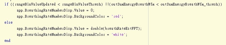

  • The GUI of vital signs demo is used to decision breathing rate and heart rate.
    In breathing case, if rangeBinValueUpdated is greater than the threshold, it means someone in the scene. If outSumEnergyBreathWfm is greater than the threshold value, it means that the person being measured has enough energy to breathe.
    If I understand the above correctly, I want to use the characteristics of rangeBinValue to search someone in the scene and determine the range of the measured person without knowing the distance.

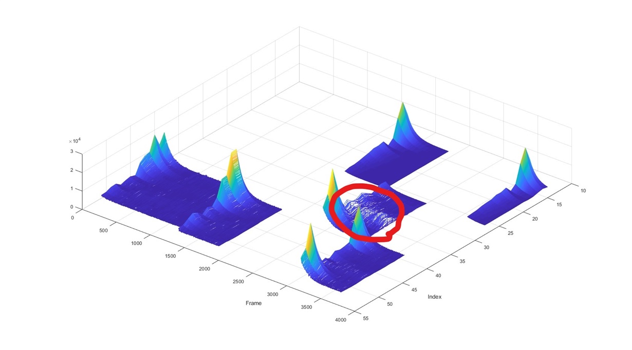

    So I tried two situations, one is that there is always someone during the measurement, and the other is that someone is always sitting at 2.3m from the radar. Then I plotted the range profiles for each frame in both cases and compared them.
    Pic1. No one
    Pic2. Someone is sitting at 2.3m from the radar
    But both cases have a large value at the beginning of the switch Index. It will affect the judgment of whether someone is in a certain range.
    I want to ask what is causing this situation? Thanks!
